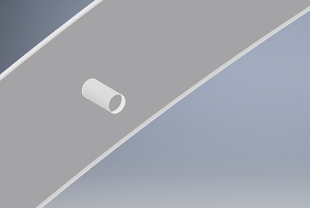

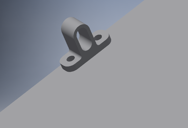

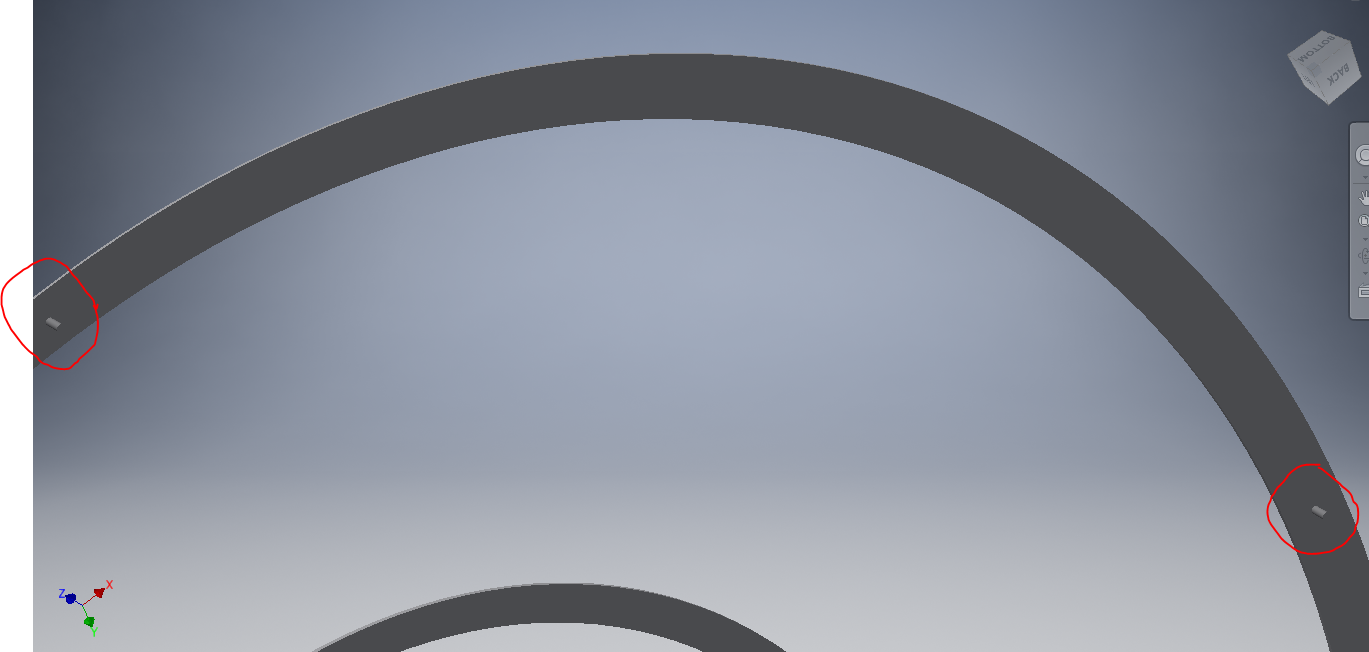

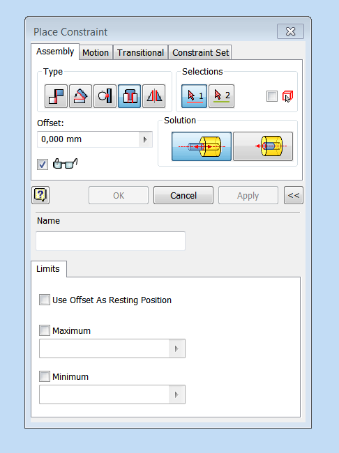

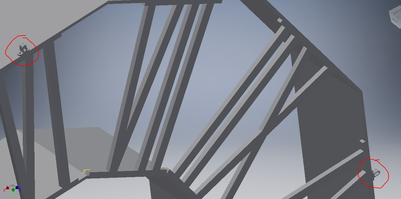

How to join a part from two points simultaneously Damian Fowler 4 Jan, 2016 02:50 AM Hi, I was just wondering how i can join two parts together (part A & part B), while aligning two shafts (on part A) with their respective housings (on part B). See attached pics for further details. Thanks 4.PNG 3.PNG 2.PNG 1.PNG 1 Answer Alessandro Marconi Answered on 15 Mar, 2016 11:53 AM When place constrain use type "Insert". Constrain Insert.PNG
