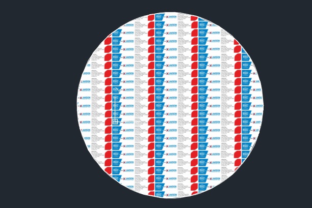

I want to decorate a picture on a surface of carbon disk wheel for cycle. So, I need to change rectangle picture to circle but don't know how to do. It's radius is 622mm. Can anyone help me?
hello please follow :-
Command: SUPERHATCH
select image
Insertion point <0,0>:
Base image size: Width: 288.924988, Height: 54.239582, Millimeters
Specify scale factor or [Unit] <1>:
Command:
Is the placement of this IMAGE acceptable? [Yes/No] <Yes>:
Selecting visible objects for boundary detection...Done.
Specify an option [Advanced options] <Internal point>: a
Enter an option [Boundary set/Island detection/eXit] <eXit>: b
Specify candidate set for boundary [New/Everything] <Everything>: n
Select objects: 1 found
Select objects:
Proccessing objects for boundary detection...Done.
Specify an option [Advanced options] <Internal point>: /
Preparing hatch objects for display...
Done.
Use TFRAMES to toggle object frames on and off.
