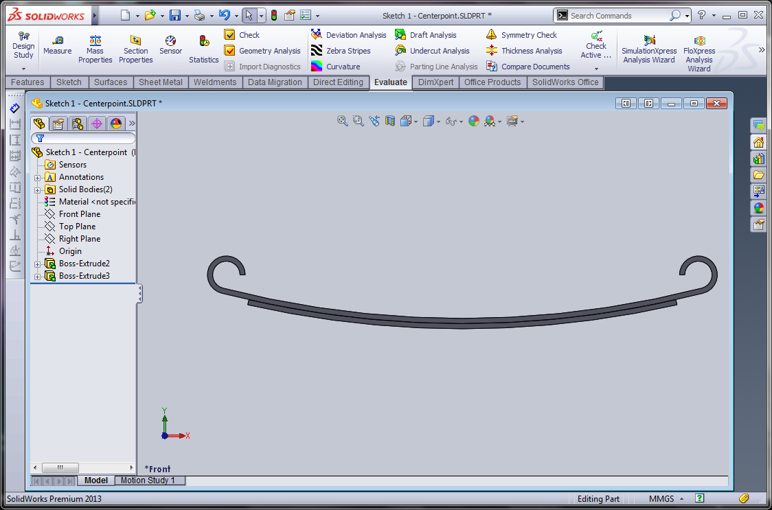

I followed and successfully created a model as shown.
I wanted to try assembly so I also modeled each leaves as separate part and then used "mate" while creating assembly.
