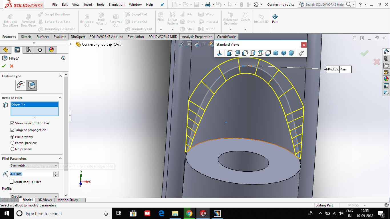

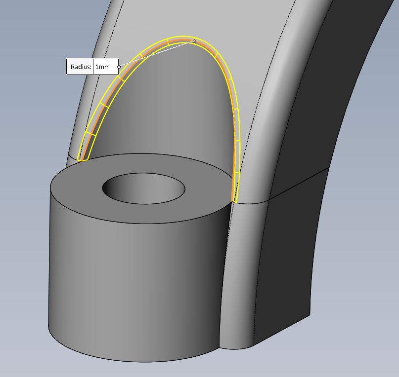

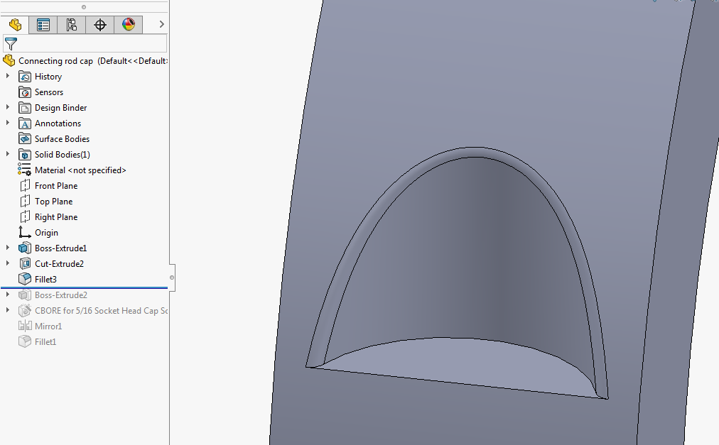

Problems in applying fillets in solidworks Poorvi Shetty 10 Sep, 2018 04:52 PM Cannot apply fillets of 1mm in the highlighted area.But fillets more than 1mm can be applied Screenshot (95).png Connecting rod cap.SLDPRT 2 Answers Robert H. Answered on 10 Sep, 2018 05:35 PM Though I can't see precisely why it won't work with 1mm in this example (it starts working at 1.8mm), I found a workaround utilizing 'split' feature to isolate the geometry needing filleted and 'combine' feature to put it back together again. workaround.JPG Connecting rod cap w_1mm fillet.SLDPRT FredSWUG Answered on 10 Sep, 2018 10:09 PM A 1mm fillet works fine for me. If you had to, you could reorder the feature tree to place the cut and fillet before the boss-extrude2 feature. Untitled 1.png
