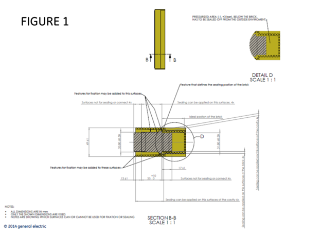

Full-sized Diagram (Figure 1) available by clicking the “Download Specifications” button.

  • Technical requirements:
    1. Part dimensions must maintain dimensions of Section B:B in Figure 1 (Figure 1 also available in pdf and CAD file formats on this page);
    2. Cavity ideally one piece but can be made out of two or more;
    3. Fixed and modifiable dimensions according to attached drawing;
    4. Materials (should be compatible to work in a water environment with a temperature range of 1 to 40 degrees centigrade):
    - Brick: Currently urethane (poured into a shaped manufacturing mold)—but open to
    - Cavity : Injection molded plastic,
    - Sealing: To be defined in your proposal,
    - Quick connect elements: To be defined in your proposal;
    5. Sealing: Water tight seal; holds -1 to +3 bar pressure (pressurized volume shown in Figure 1, Section D);

  • Devin Sidell
    Devin Sidell almost 11 years ago
    Lisa,
    Can you help to explain a little better what this is exactly? The diagram is blurry.
    Devin Sidell has uploaded 49 CAD models & has left 240 comments.
  • Lisa Ralph
    Lisa Ralph almost 11 years ago
    Hi Devin,
    Great question! The full-sized diagram (Figure 1) is actually available as a PDF (also, same in the CAD model), which can be accessed by clicking on the "Download Specifications" button at the bottom of the "Requirements" section. The PDF will show a few views (Section B:B and Section D) that should provide a little more clarity.
    Please let me know if you have any additional questions!
    Many thanks,
    Lisa
    Lisa Ralph has uploaded 0 CAD models & has left 14 comments.
  • Attila Tarjan
    Attila Tarjan almost 11 years ago
    Hi Devin,
    Please try to download the specification. This is a simplified version of a product feature where we are looking for quick connection and reliable sealing inbetween, as described in the technical requirements.
    Regards,
    Attila
    Attila Tarjan has uploaded 0 CAD models & has left 31 comments.

  • Abhijeet Das
    Abhijeet Das almost 11 years ago
    Another challenge!! great!! I love GrabCad!!

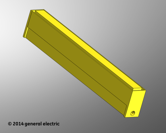

  • kip gunter
    kip gunter almost 11 years ago
    the 3d model appears to be one piece when opened, can't separate the connector
    kip gunter has uploaded 3 CAD models & has left 6 comments.

  • Attila Tarjan
    Dear Kip,
    You should see 2 separate parts in the 3D, brick and the cavity, it is an assy in step format. Please give me some details how it opens in your cad software.

  • kip gunter
    When I open the 3D file I can see the two parts, but can't select or separate them I use Rhino software

  • Attila Tarjan
    Hi Kip
    Unfortunately I do not have any experience with Rhino… I use Solid Works when I import the step it recognizes the assy and both parts. They are editable. Any possibilities for you to open in other CAD software?
  • ANOUAR BARODI
    ANOUAR BARODI almost 11 years ago
    @ Kip gunter: When you open the stp file with Rhino, you'll Object name: Quick connect assy 12F
    Layer name: Default
    Select the object and then Click on explode once and so you'll have the two objects, good luck!
    ANOUAR BARODI has uploaded 98 CAD models & has left 1654 comments.

    The challenge seems clear enough, there is a plastic brick shaped object, it fits inside a plastic box shaped object, seal it so it does not leak and fix it so it does not fall out. Come up with a quick and clever concept that will be easy to do, worry about the details a bit later. Am I missing something here?
    Gerard O'Donoghue has uploaded 43 CAD models & has left 80 comments.

    It’s mentioned in the tech requirements that part must meet dimensions form the pdf. The 49+/-1 should be ideally kept unless there are no other solutions.
    Pressures from -1 to 3 bars represent the pressure differences between the chamber in the cavity and the environment (see “detail – D”). Due to this loads from the inside pressures will have different directions.

    Brick is one part only, geometry is defined on the pdf drawing.
    Related to proofs, I agree with you that all contesters should focus on conceptual solution(s) in the beginning, but we would like to encourage the entrants to check the details of their designs and submit a working concept.

    1. With this we open the possibility for the concept, you can use a cover for example to close the cavity and seal…
    2. Brick is one part only. You have to connect it with the cavity and seal. (See the pdf)
    3. Fixed is only what is dimensioned in the pdf, there are suggestions where to seal or add additional features. Outside of the cavity has the 49+/-1 should be that ideally. If something needs to hang out should be minimal.
    4. Cost is a factor but In the concept phase it would be difficult to tell … quick connect and reliable seal are much more important.

    Hi Louis,
    Brick corners can be rounded if you keep the part width and length as on the drawing

    There are better images in the specification. Please download.

    1. Why the large gaps between the cavity inner wall and the brick's outer walls on the "back"?
    2. Why does the brick have steps on the seemingly not so important "back"?
    With that said, I haven't seen anything in the specs that those features can change (to be quite honest I did not read in too much detail), are those features adaptible to make material use less and to ensure minimum dirt and grime growing/accumulating in the back that might cause it to not release when you need to open it? Will the brick be mechanically inserted and removed, therefore requiring the space?
    PS: I like the secrecy hopefully not to be used in some doomsday device, hehehehe

    1. The submitted 3D is a schematic reflecting the current product going into this challenge we could not predict all situations or needs that may come. The free space between should be used for adding the sealing and connect features, you can make it smaller or solve this by adding features into it as written in the notes. Important is not to go above 49+/-1mm.
    2. Steps on the brick represents some functional areas, as a guideline for connect and sealing there are notes on the drawing showing which surfaces are good or not good for connecting and sealing.
    Eventually we will need to solve the gap between as you said to avoid any accumulation inside, however in this stage we targeted to get connection and sealing concept, but if you solve all that it’s even better. If you have something specific on your mind we can discuss it.

    Drafting is just for example, you can change it as long as you do not go out from the width 49mm.
    Originally we would like to use this surfaces and this gap between cavity and brick to add the connection and sealing features.
