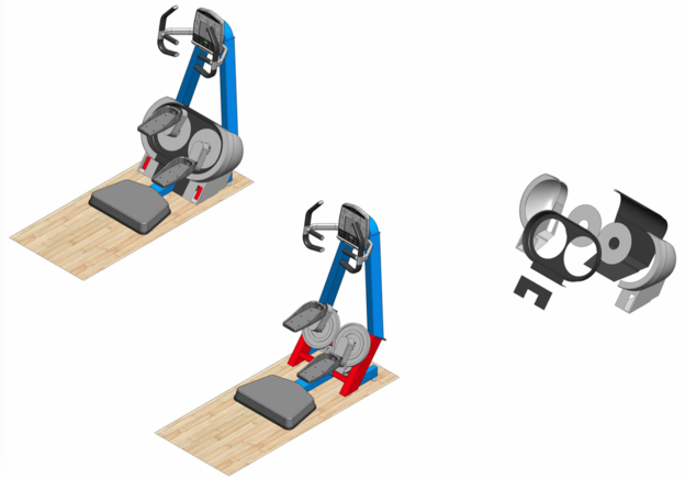

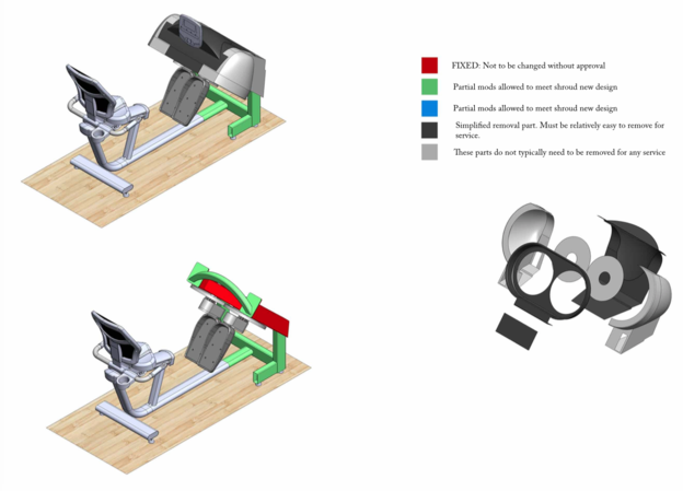

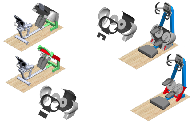

The goal of the Universal Lateral Trainer Casing Design Challenge is to design casings for the two exercise machines (upright and recumbent) with as many common parts between them as possible. For example, if a casing has 4 parts in total, 2 of the parts may appear in both the upright and recumbent versions. To extend the analogy to automobiles, two cars may have the same fender and front bumper, but different hoods and grills in order to accommodate different features. Many of these parts will need to be readily removable so that the machines can be cleaned and otherwise serviced. Some of the casings do not need to be readily removable for service and this is highlighted in the instructions.
Please refer to the images of the current upright Helix to confirm what is considered the “casings”. IMPORTANT to note that the current design is just a representation of how the machines need to be “shrouded” and not necessarily a suggestion of design.
You can download STEP / IGES files of the trainers and additional instructions below.

    - Smooth, aesthetic, simple, matching the trainers.
    - Designs with as many common parts that are used on both units as possible.
    - Specific parts of the casings will be easily removable for repair or service access.
    - Manufacturable with low costs and with common methods.
    - Durable.
  • Technical requirements:
    - The designs must be finalized and fit to the existing metal frame weldments and overall design. You can download Step / Iges file below.
    - Injection mold design is not required. However it is expected that in areas that are suspect to ribbing or otherwise to support the plastic, these additions will be included.
    - Material thickness of the plastic casings should be no less than 4mm.

    Hello and thanks for the tip. The casing design shown is not the current design. it is somewhat of a place holder to give the idea of what is needed. We're looking for an innovative solution to case both configurations with as few parts as possible. We'd like the casing design to be "Slick" and maybe somewhat "automotive". Not too racy but not "Prius" either. Hope that helps!
