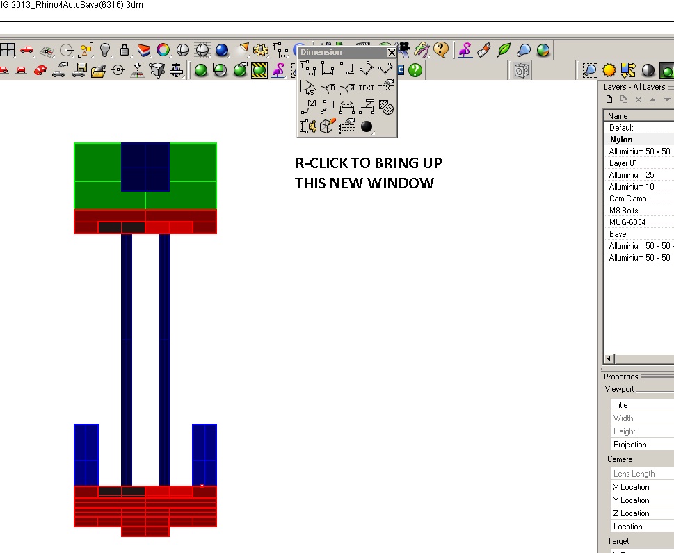

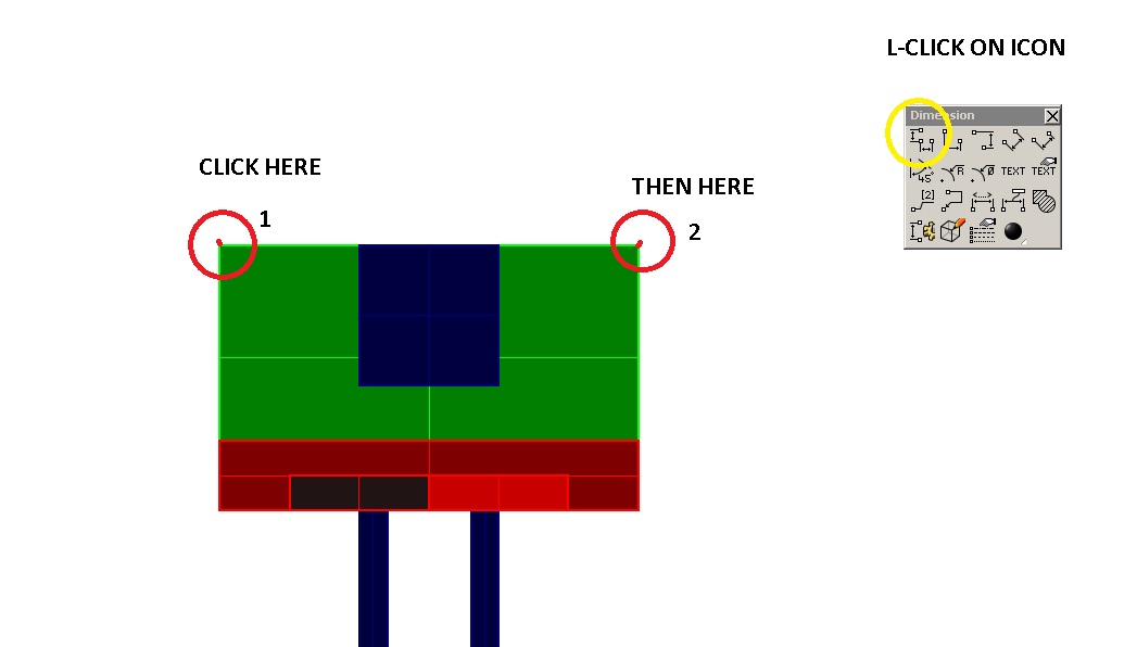

Dimensions always measure as though the object were projected to the current construction plane.
1. use linear dimension for measuring length and width measurements.
2. use aligned dimension for diagonal measurements.
Answered with a tutorial: https://grabcad.com/tutorials/how-to-measure-in-rhino

I would go to Analyze on the top , next to the tools, and choose distance , make sure Osnap is on ( Mid, End, Quad and etc...) then click from end to end. Also you have the obtion to change the unit, from mm. to inches or others.
I'd just type "distance" in the rhino command line and use the various snap options to snap to points i want to measure from or to. The resulting "distance" as well as other handy info is returned in the command history listing above the command line. All this is assuming you only want to "measure" something as opposed to "dimensioning it".

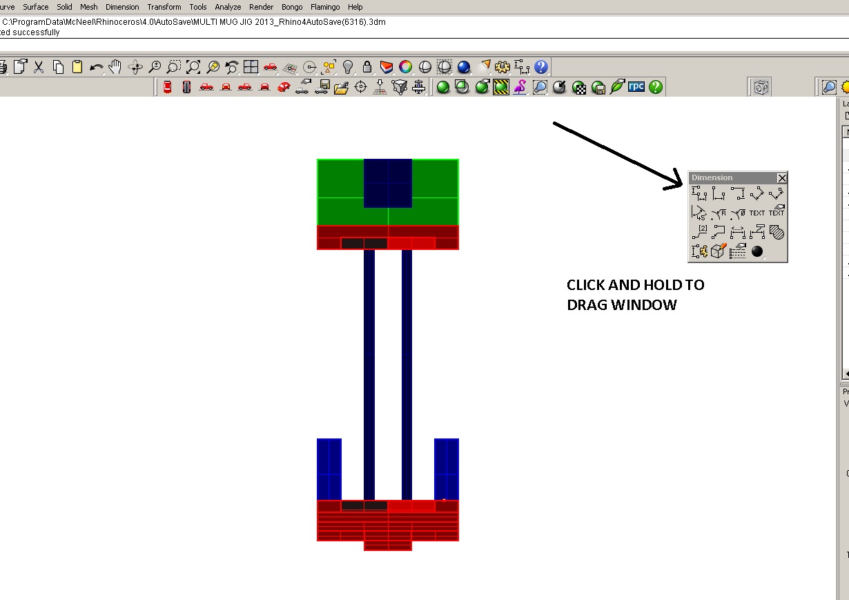

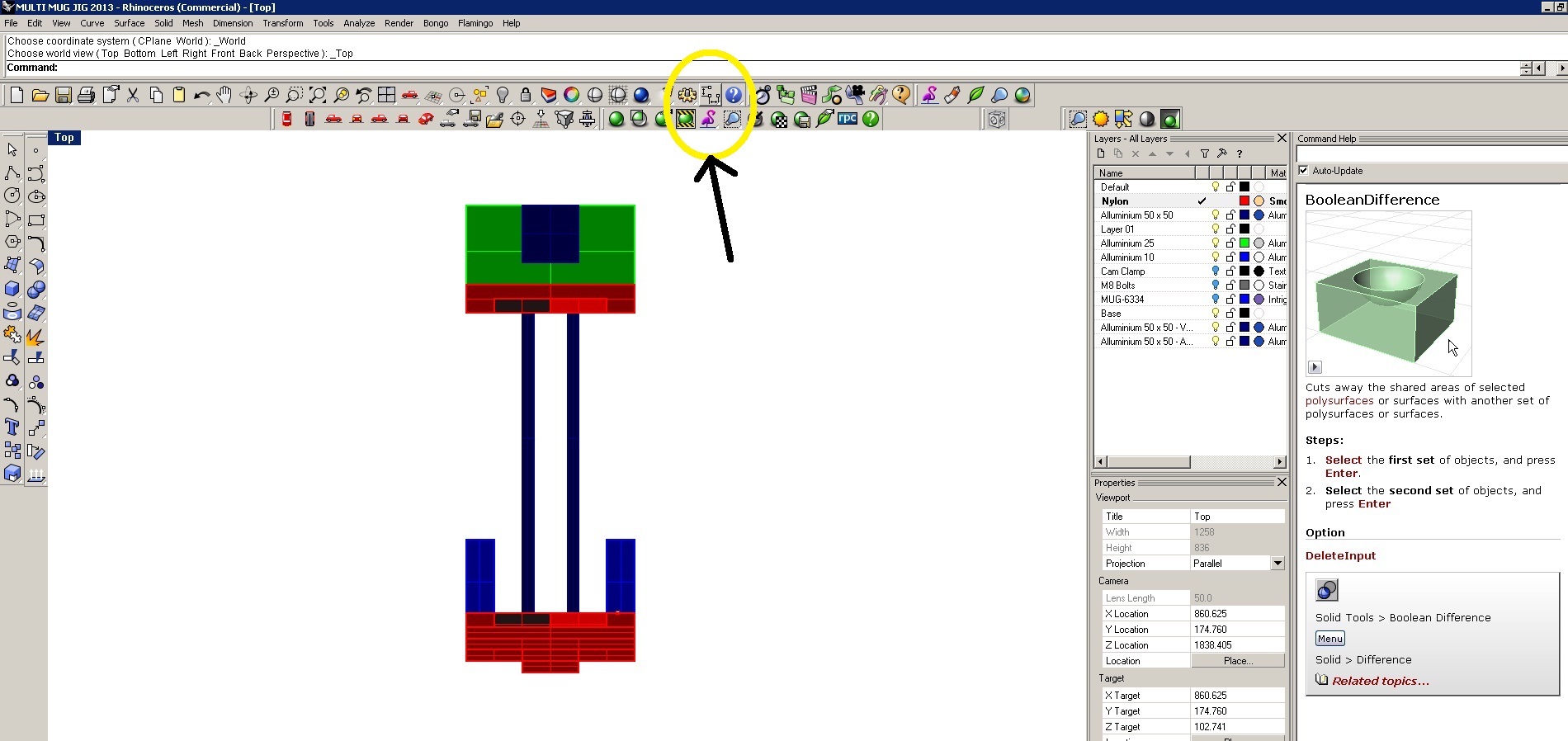

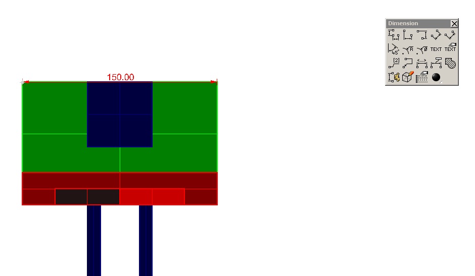

as fred said, you can use the dimension command, i use version 4.0, and in it, there is a button on the top bar that calls the command,m or you can just type "dimension" in and press enter and that will give you the distance between two points as text on your drawing.

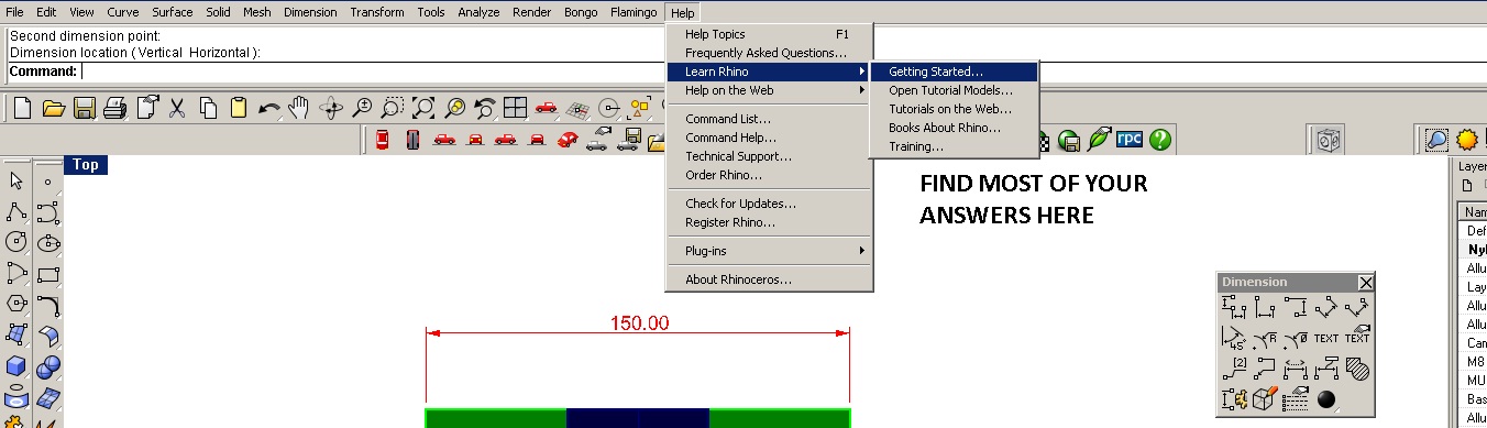

Use your Help file and do the Tutorials. It does take long, but it is the best way to learn the rite way from the beginning.

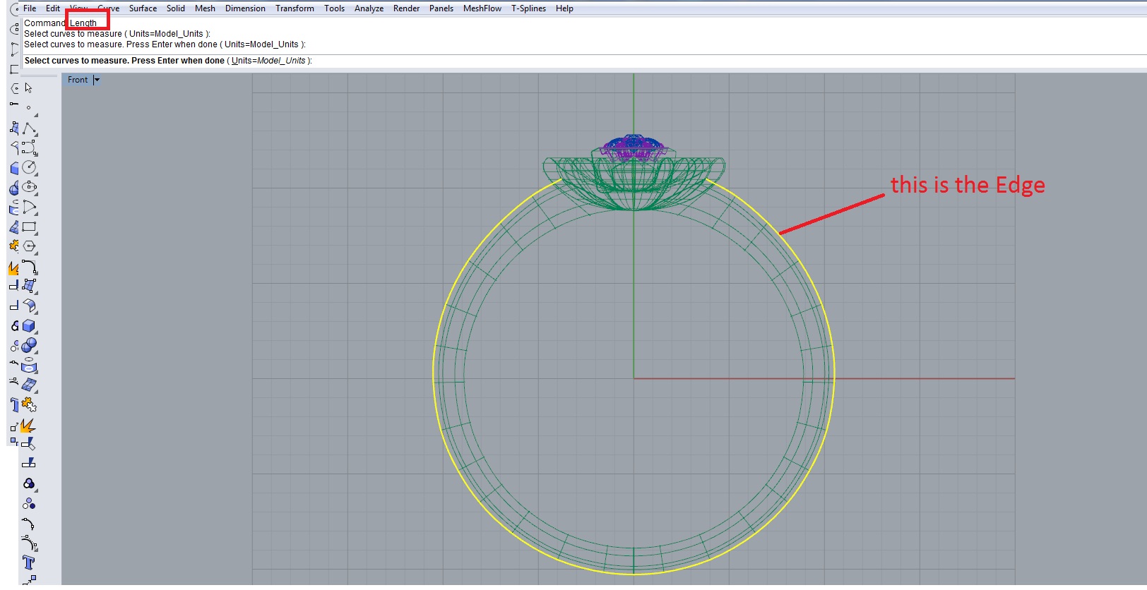

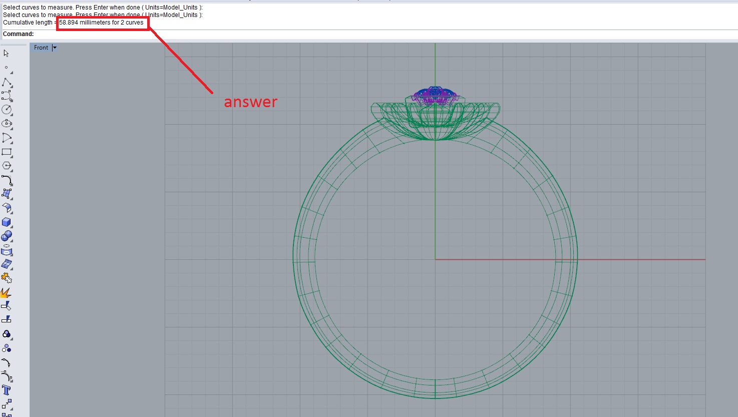

During modelling process I use very often the button called "Length" that measures length of curves or edges (s. enclosed icon picture). Just click on it, select the curve or egde and in the command line you will find the curve or edge measurement. It serves as a control tool. Fast and reliable. You can fint it also in the menu "Analyse/Length".

Better way Is
1) Type In command "length" It will ask for Length of curve
2)Select Edge of any Object or curve
3)By dimension You Couldn't Get Curve Length Or Circle Circumference.
4)for Zigzag Or Irregular Shape You can Use This Command
