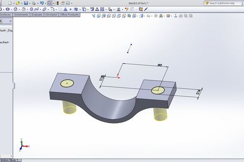

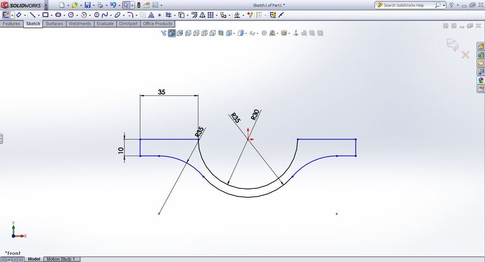

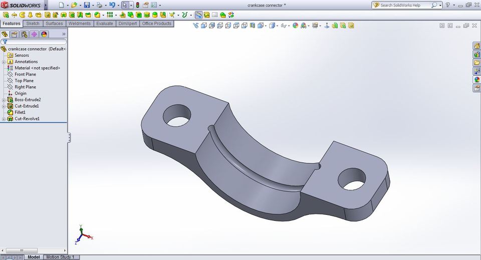

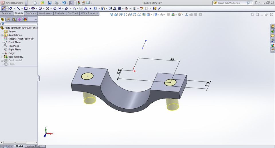

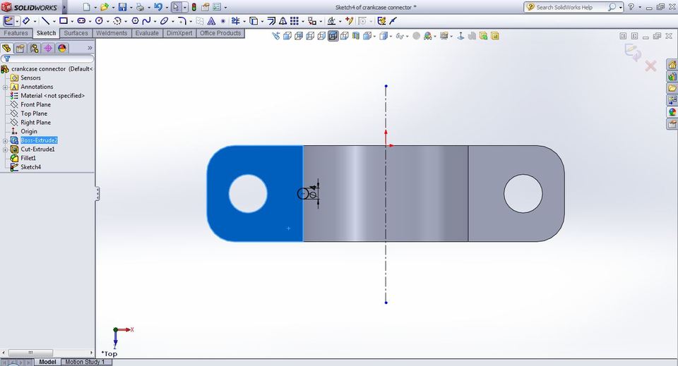

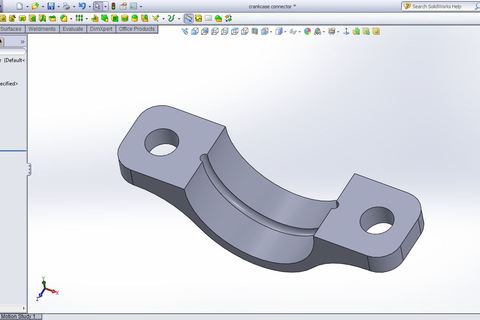

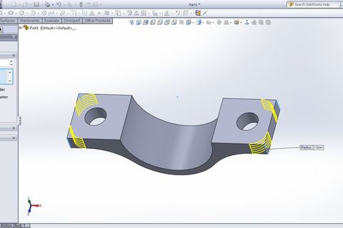

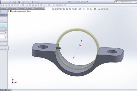

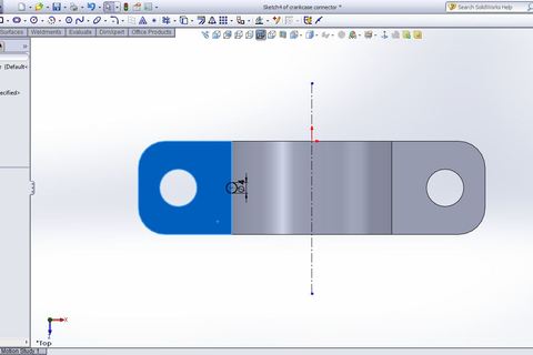

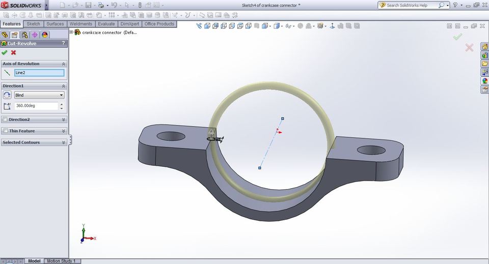

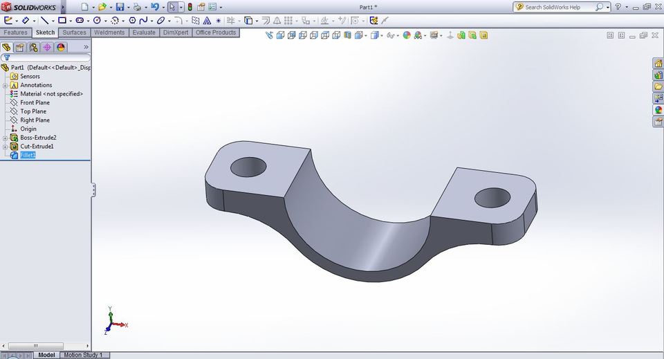

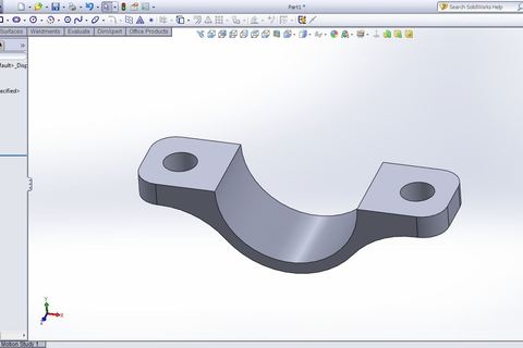

Tutorial how to make engine part 14
How to make engine - part 14 -
Crank connection part
Answered with a tutorial: https://grabcad.com/tutorials/tutorial-how-to-make-engine-part-14
