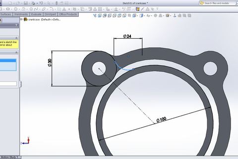

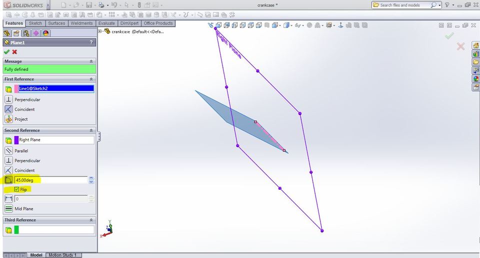

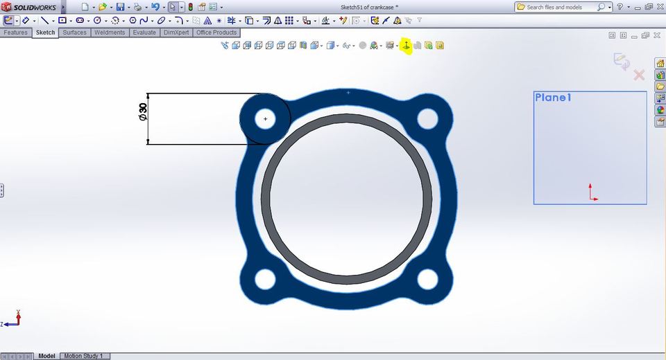

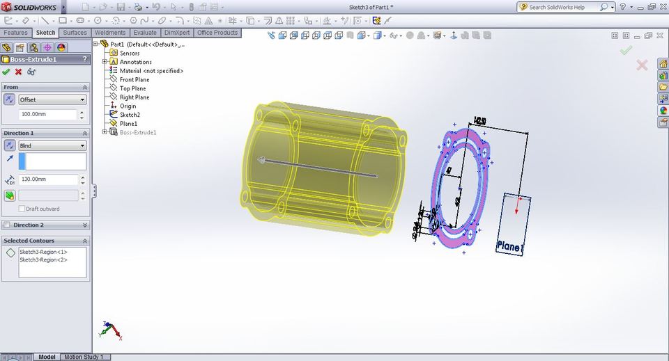

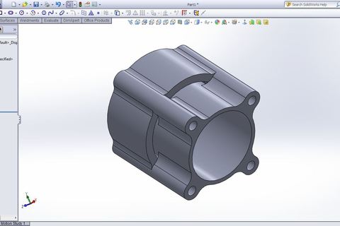

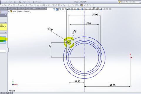

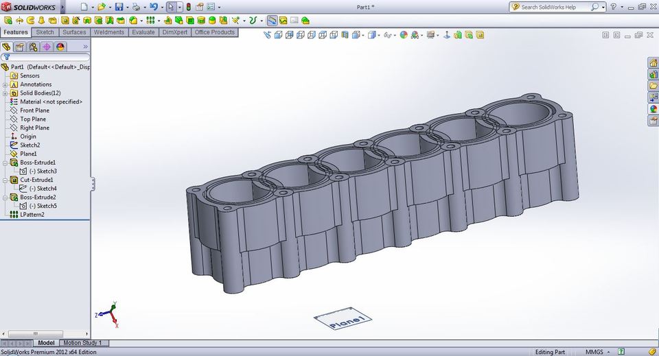

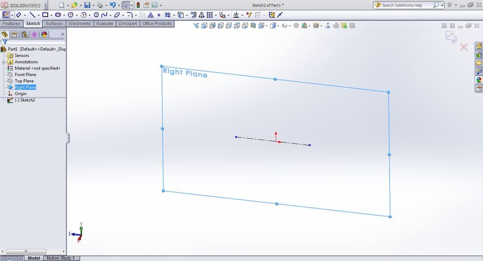

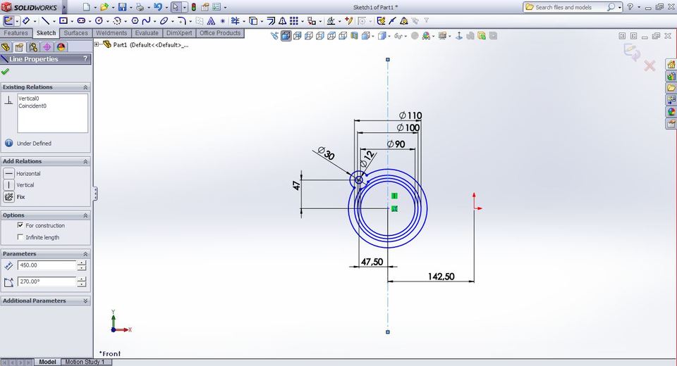

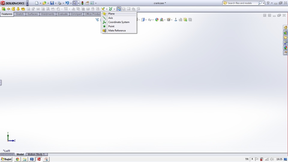

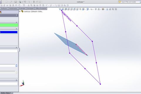

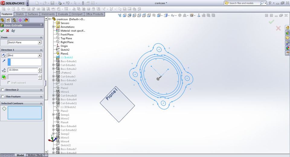

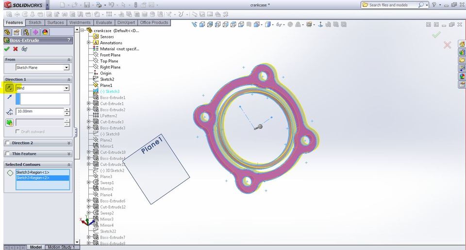

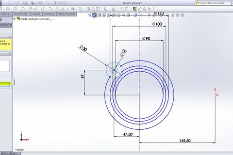

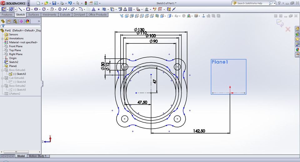

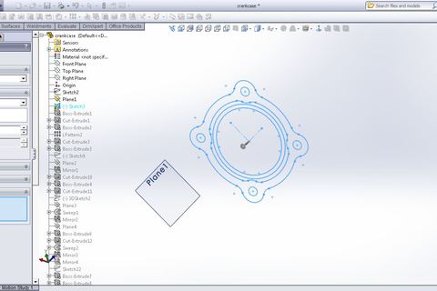

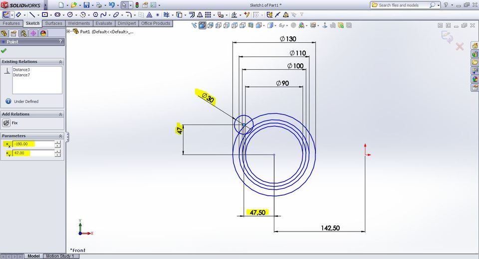

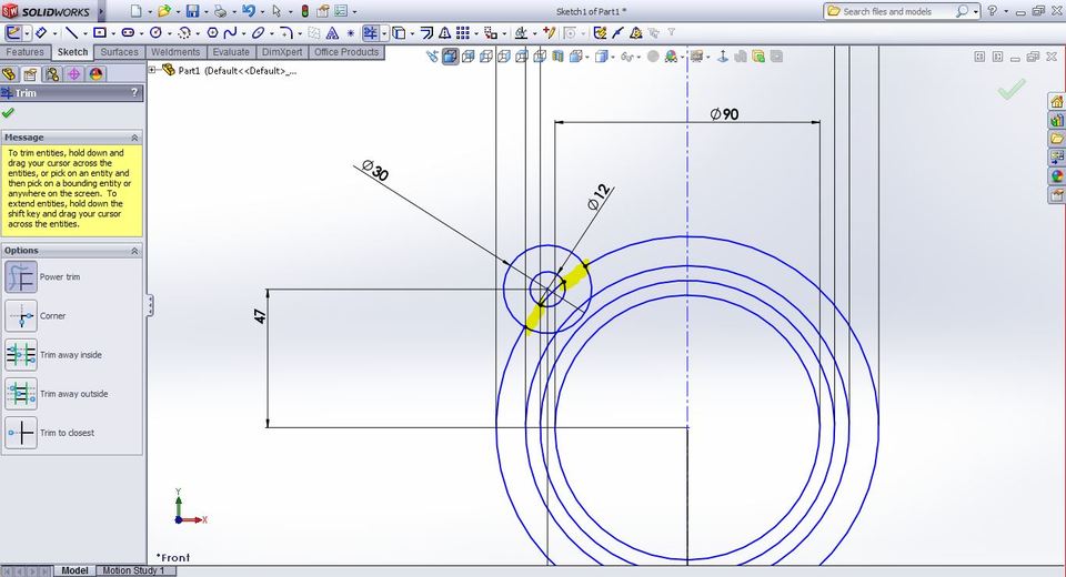

This one has me stumped right from the get go.. 35 degree what??? Ive also looked all the way through this tutorial and still havent figured out where you even use the planes!!

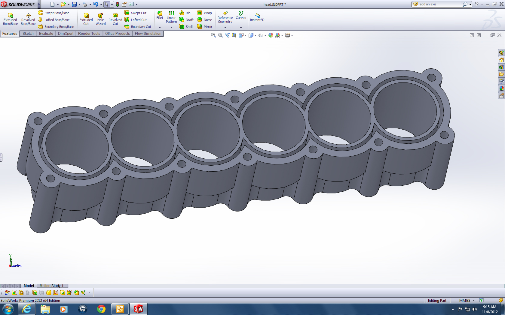

is it possible to have a solidworks 2009 part file for this model it would be really helpful to understand this tutorial better

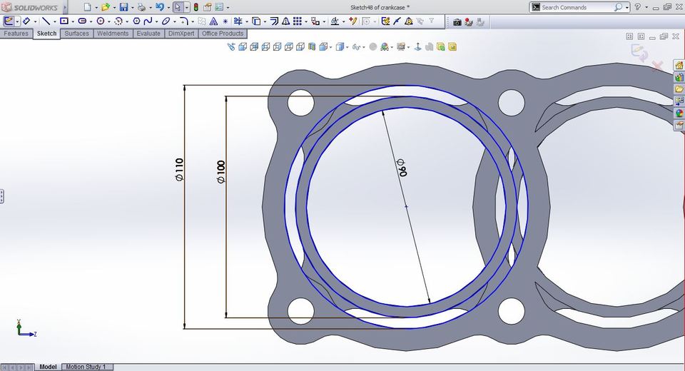

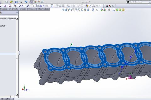

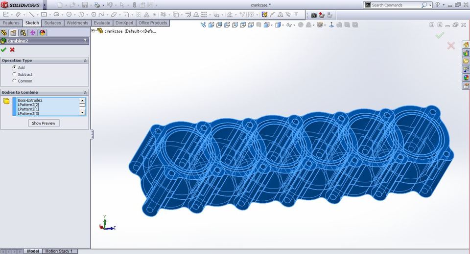

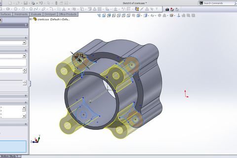

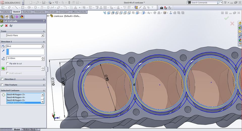

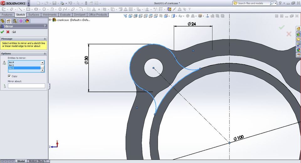

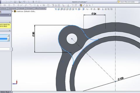

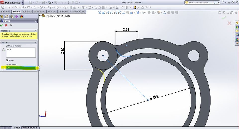

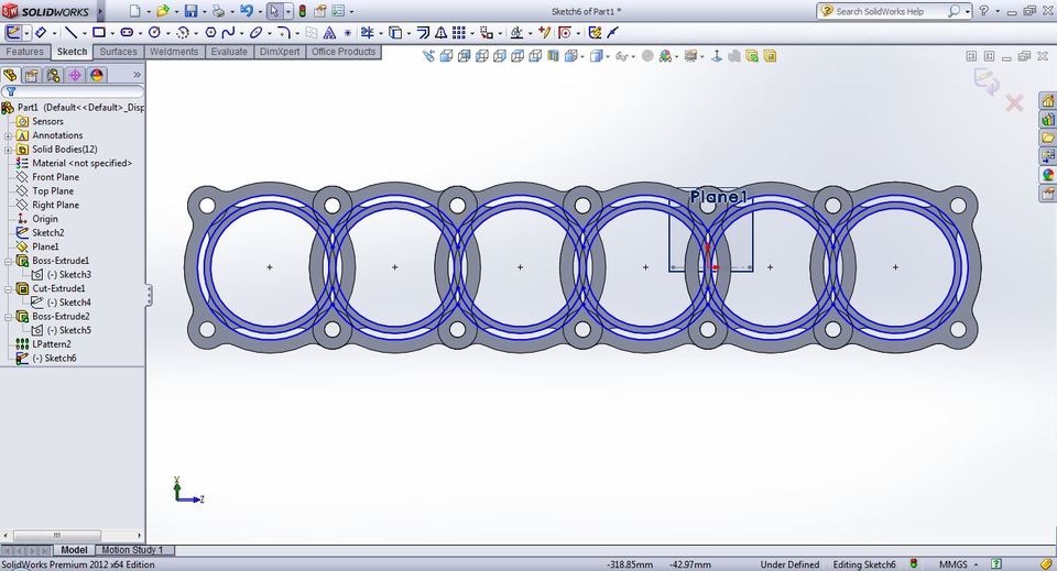

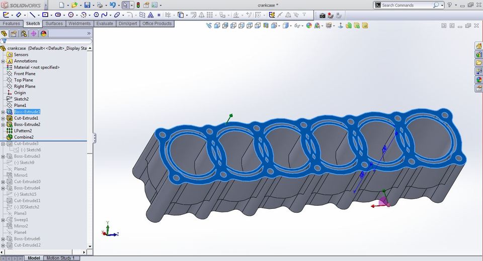

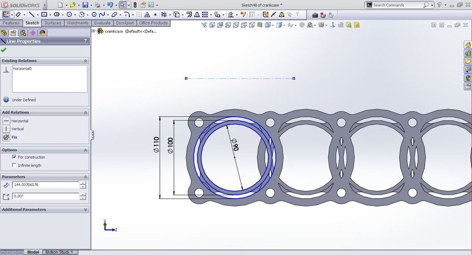

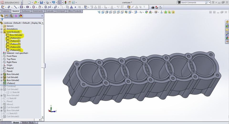

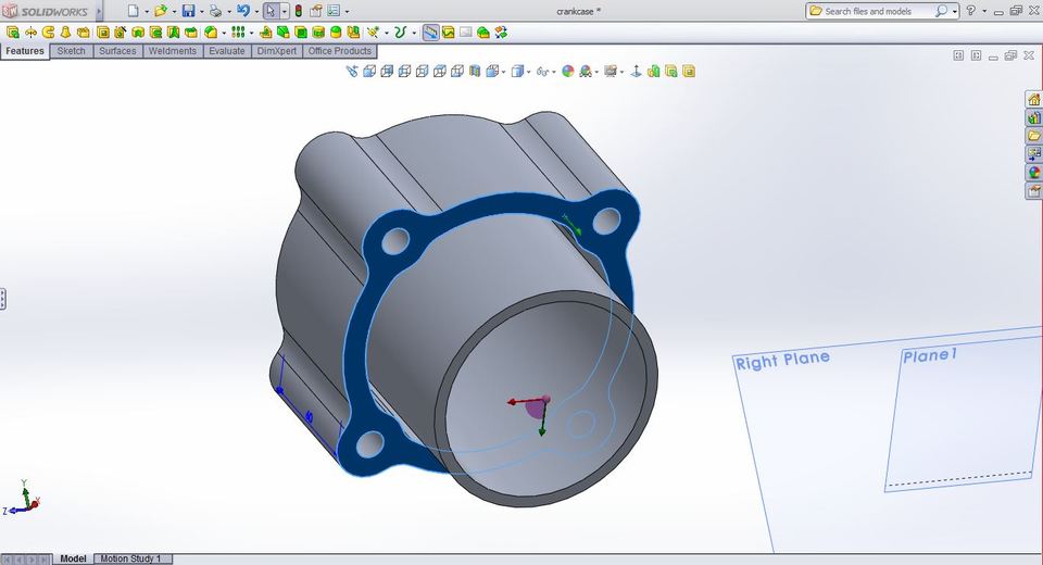

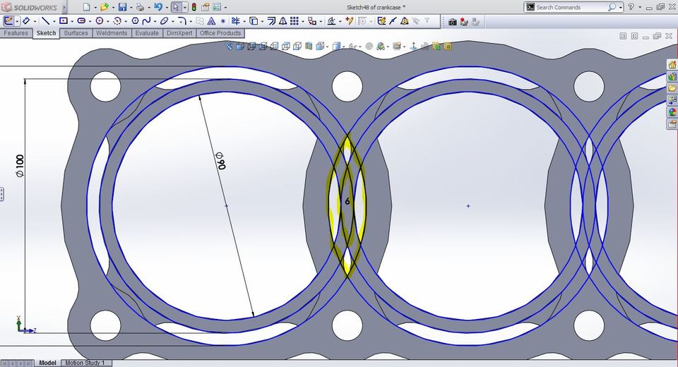

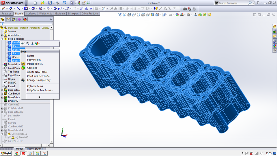

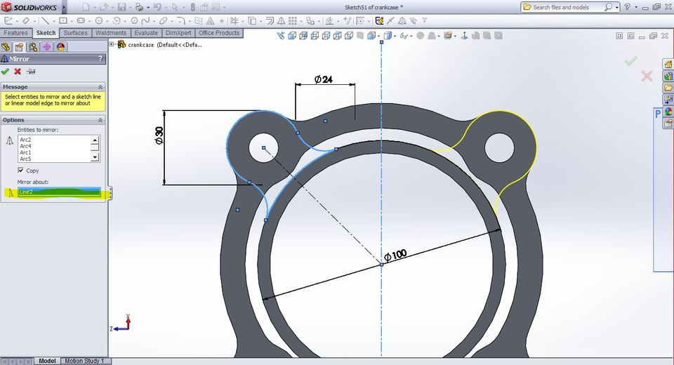

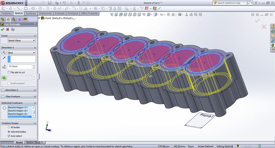

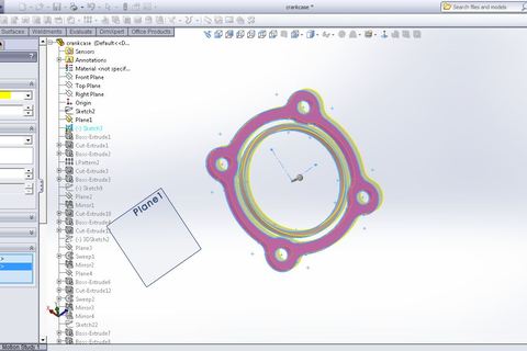

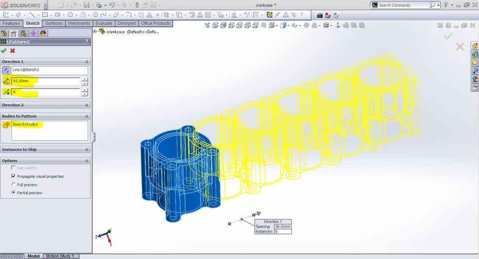

when I get to step 34 -pattern- I do not get the cut of the original. The rest come full solid. Any Help

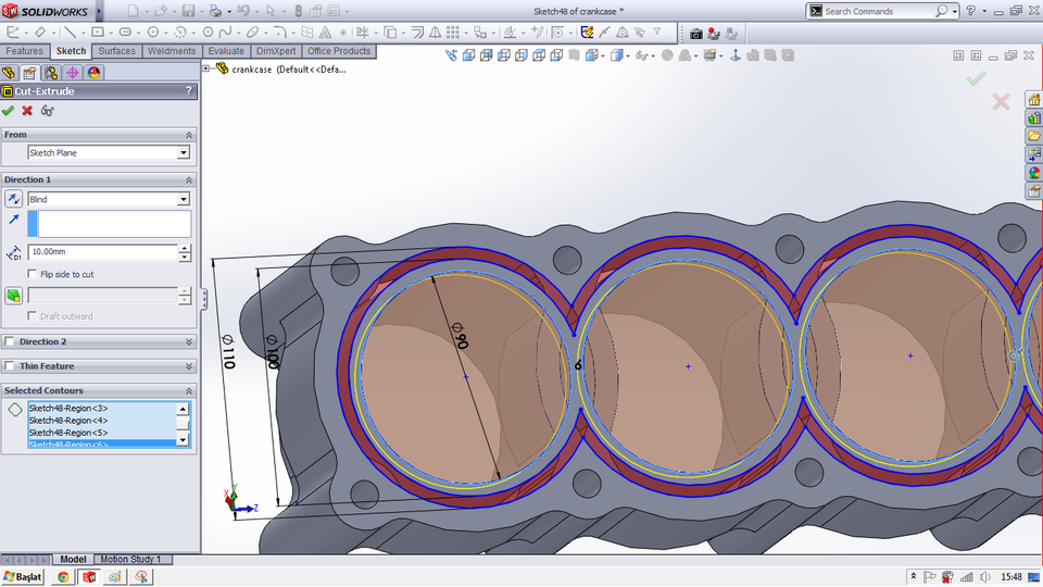

Hi everyone! First of all, I deeply appreacite this tutorial, it is difficult to find something as well explained as here is.

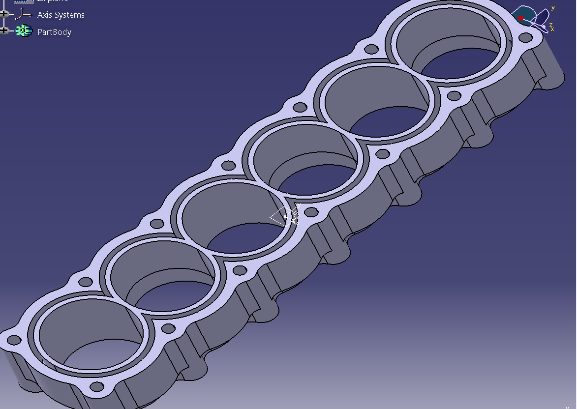

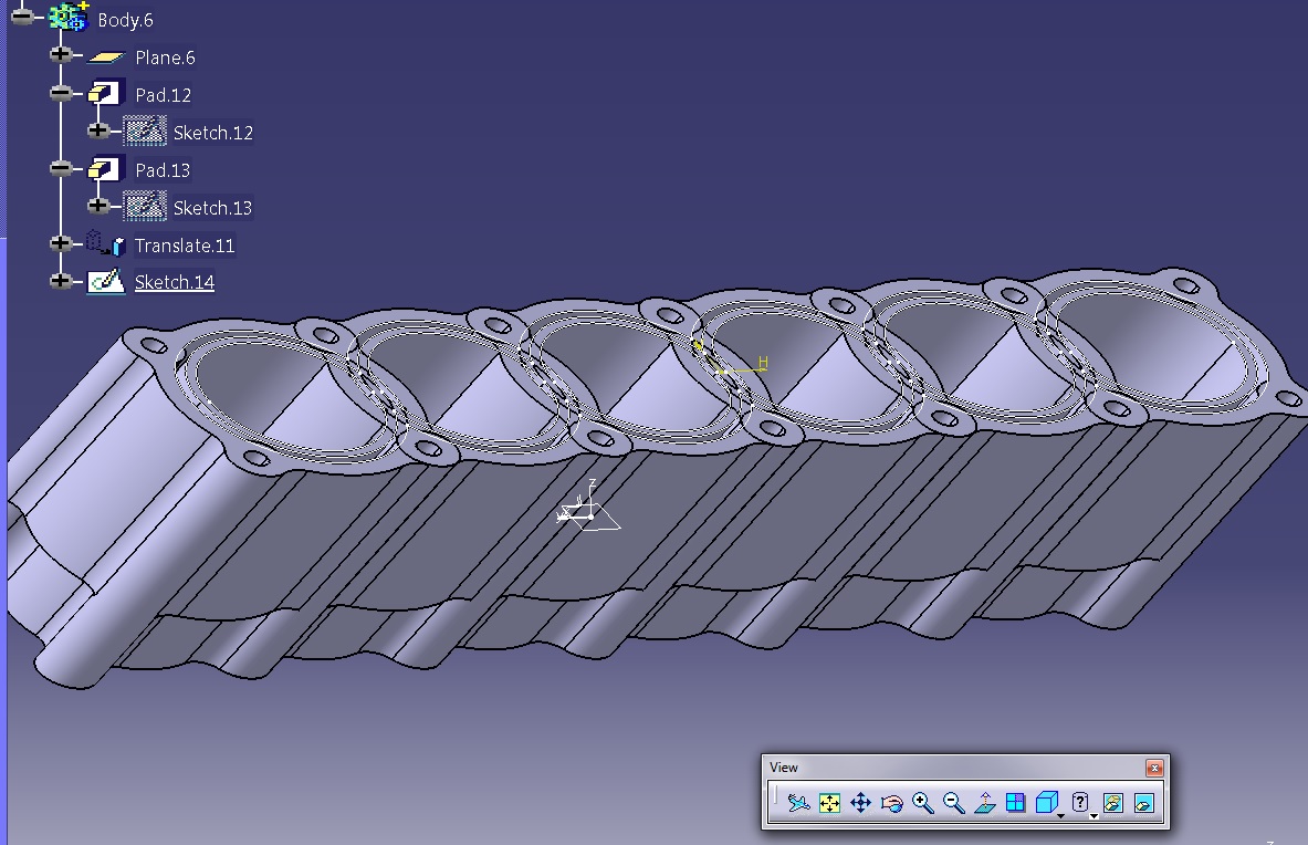

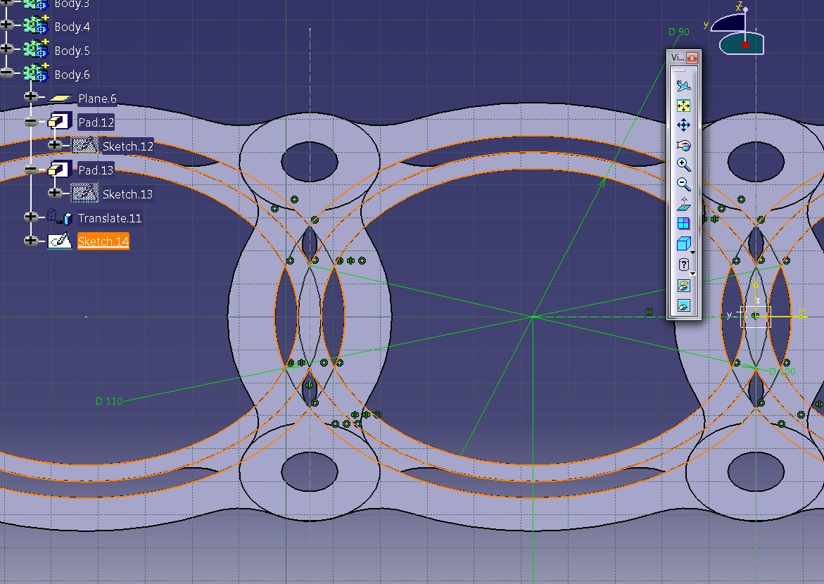

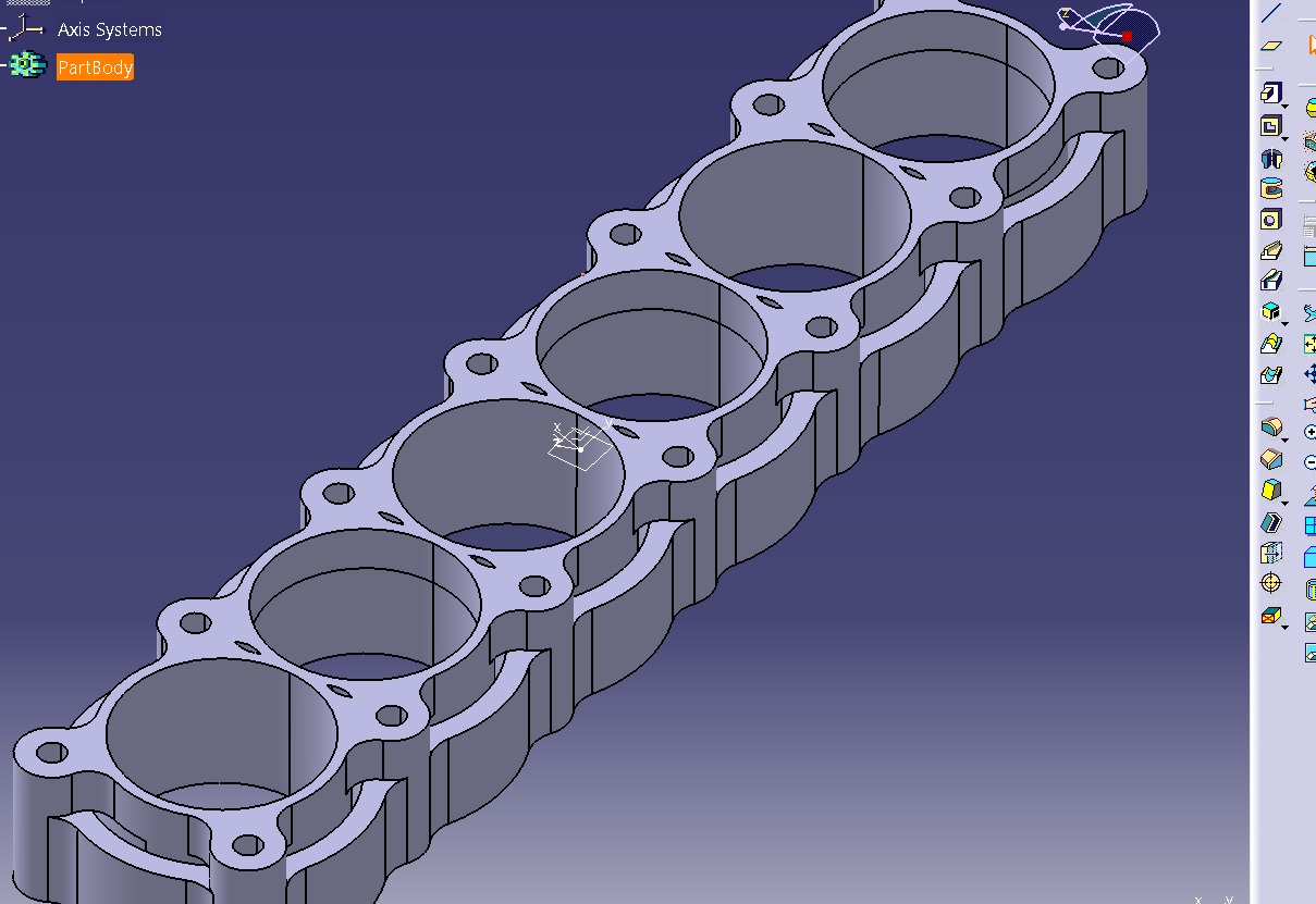

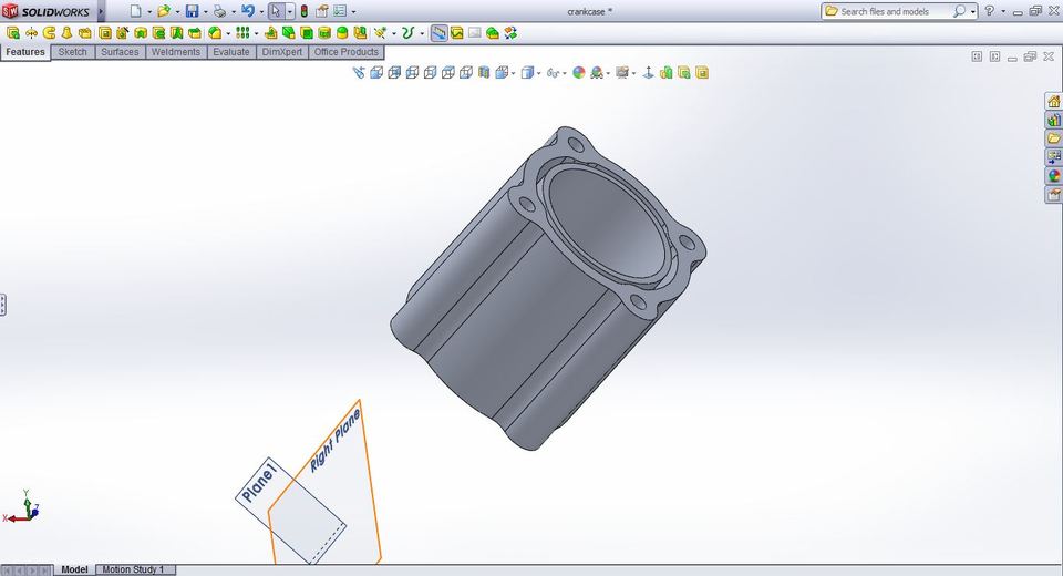

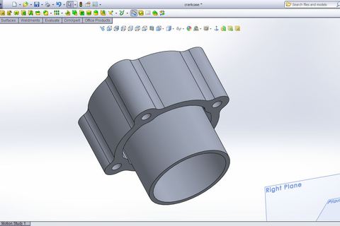

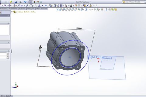

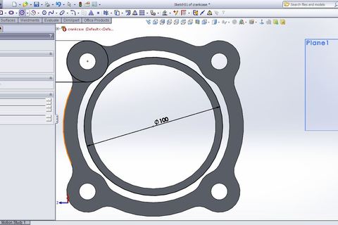

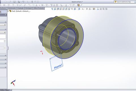

I am doing this tutorial with Catia V5, I attach the pictures of my cylinders cause I m not sure about the result from below view

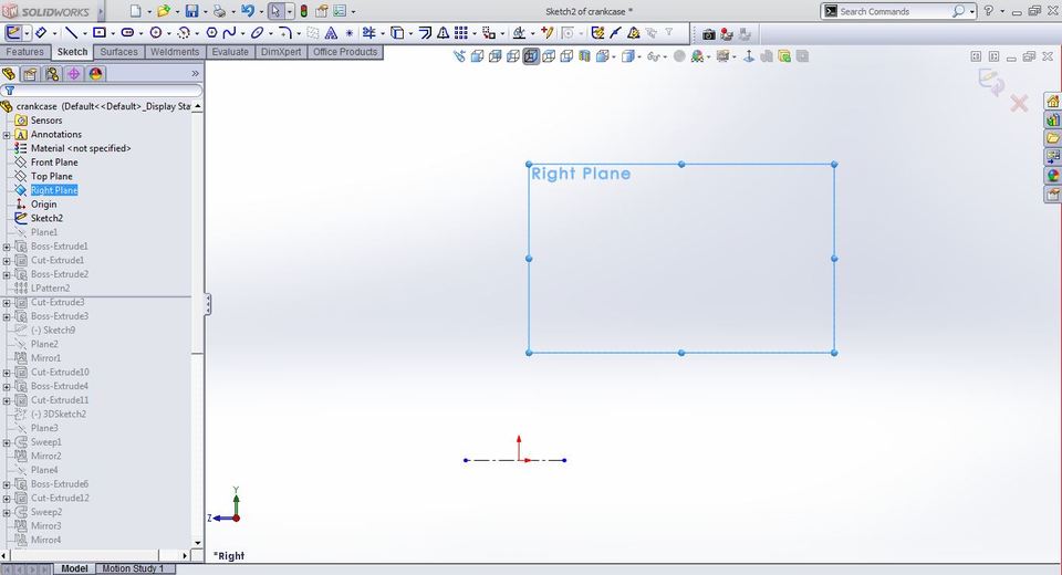

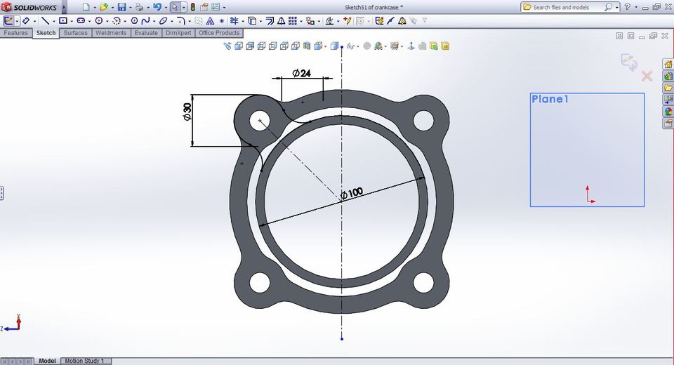

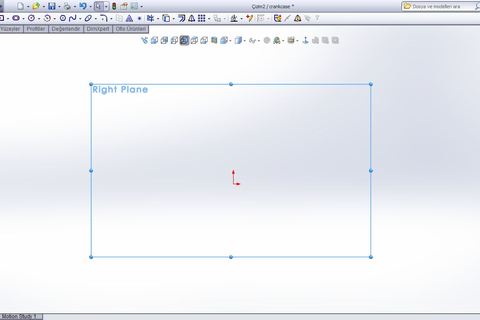

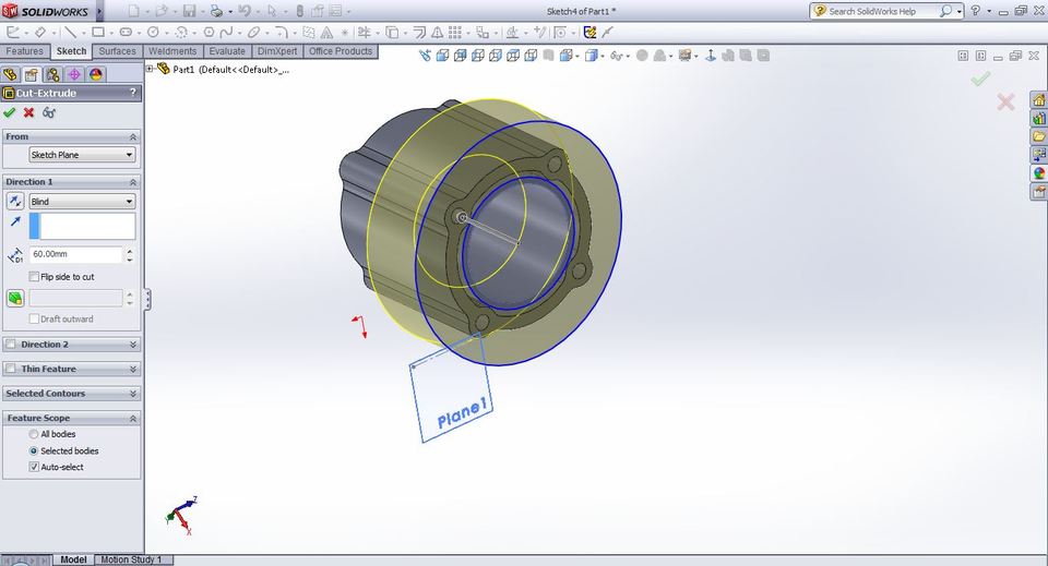

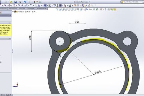

Olá, não consegui localizar no solid ( 2012 o meu) o passo 37 e 38, poderia me explicar um pouco melhor via e-mail (mateus.neves@aedu.com) ou Skype (mateus.marcondes.n). Agradeço desde já.

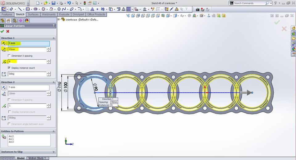

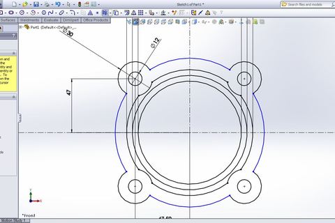

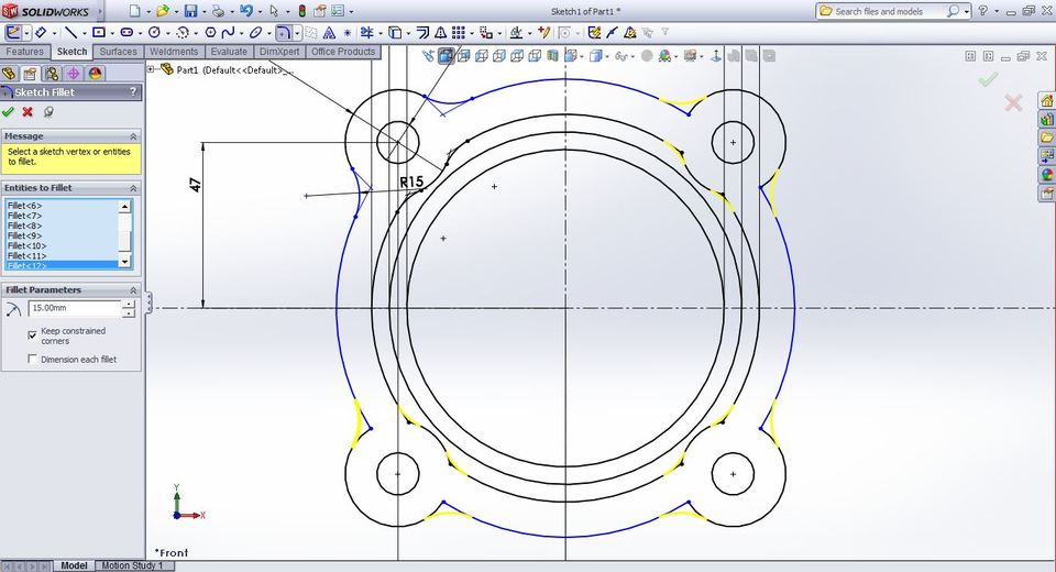

Please help! Everything has gone together very nicely, but I am trying to pattern the first cylinder and I am running into a zero geometry error when I try and pattern the features. Your help would be greatly appreciated! Thanks!

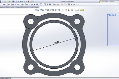

THE ANGLE OF THE FIRST PLANE IS 45!!!!! NOT 35!!!!. this will screw you over when you mirror the cylinders and make the crankcase. if you did 35 you can always rotate the first cylinder then mirror it and pick up from there

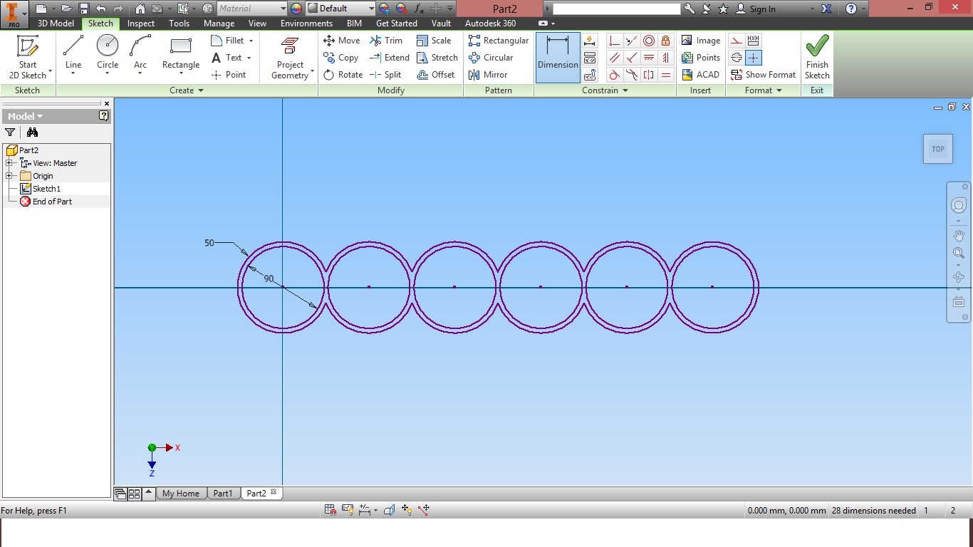

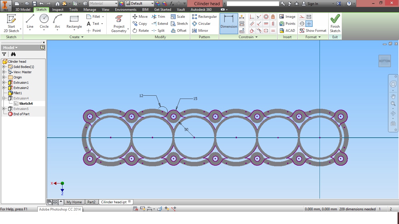

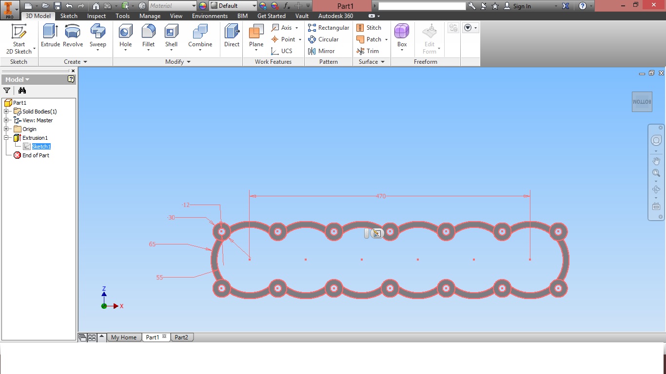

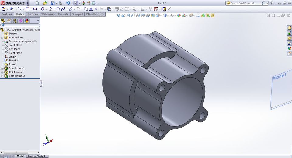

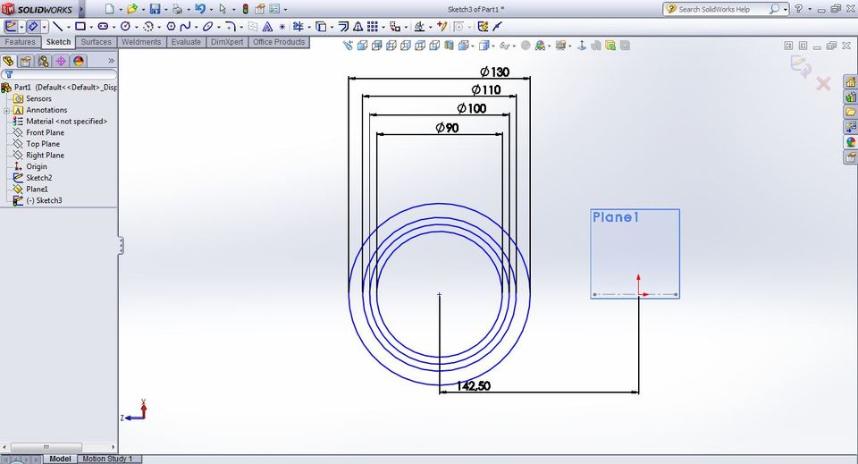

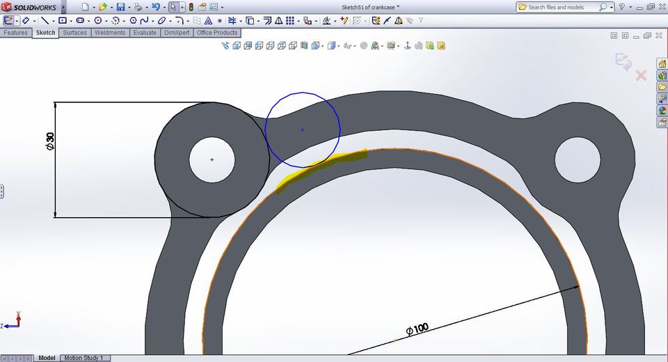

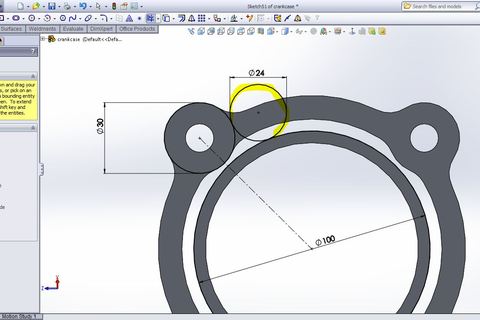

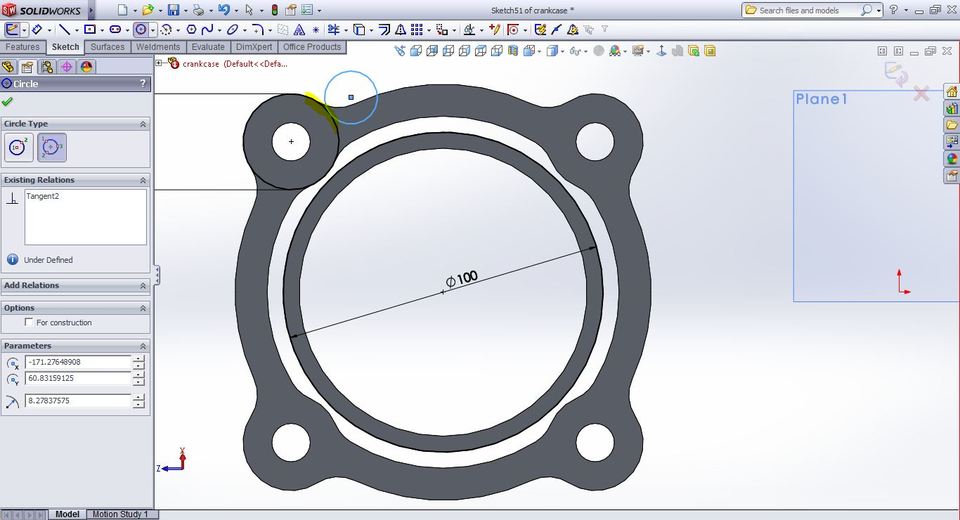

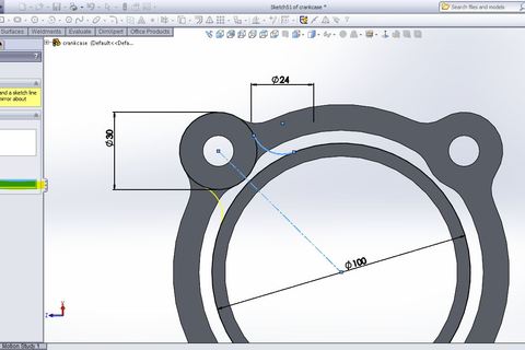

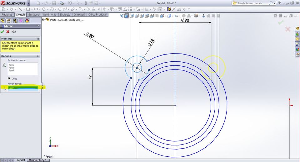

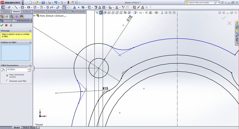

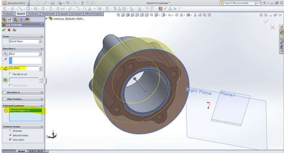

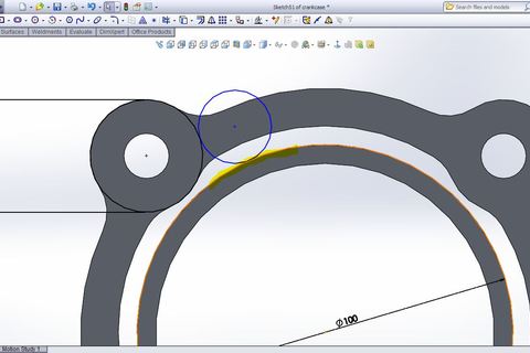

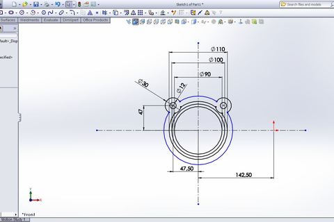

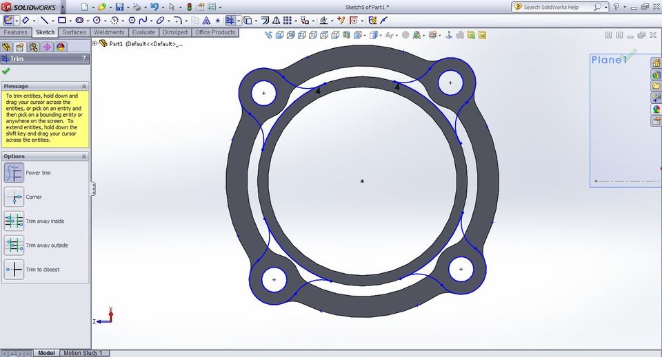

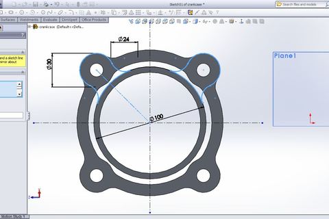

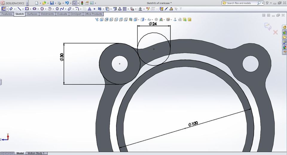

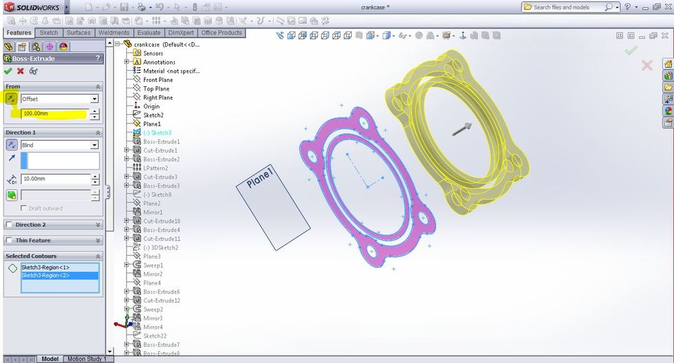

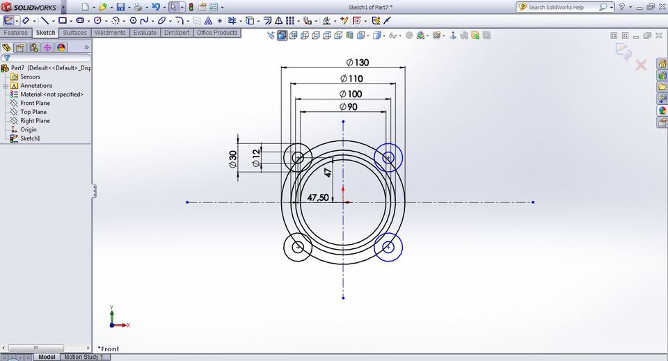

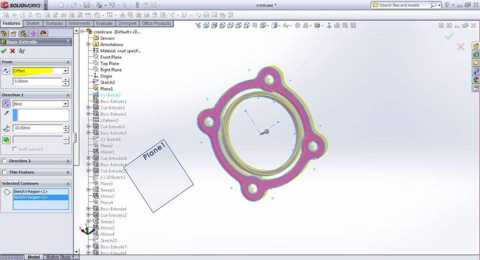

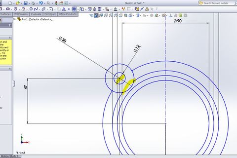

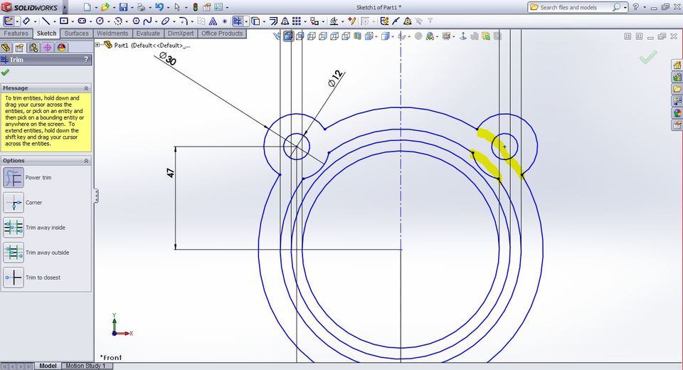

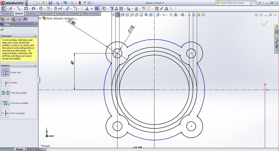

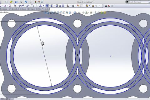

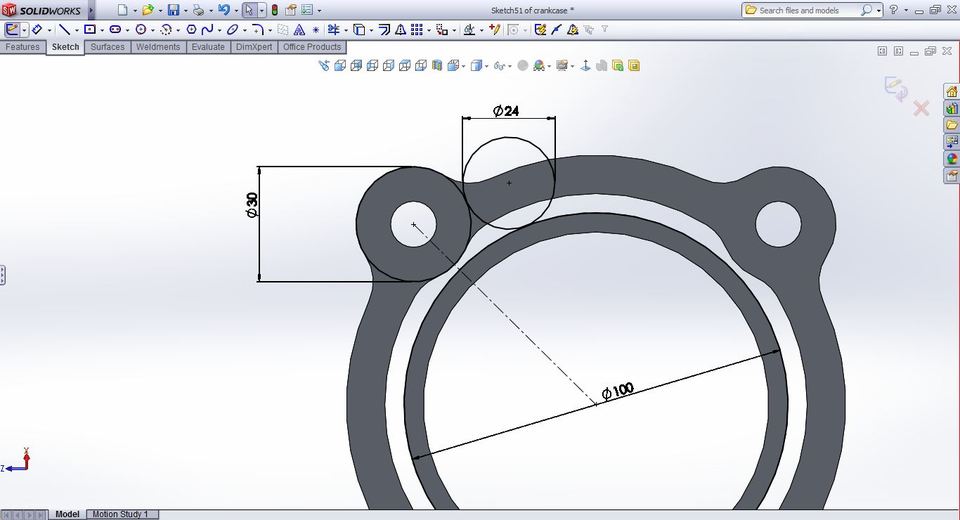

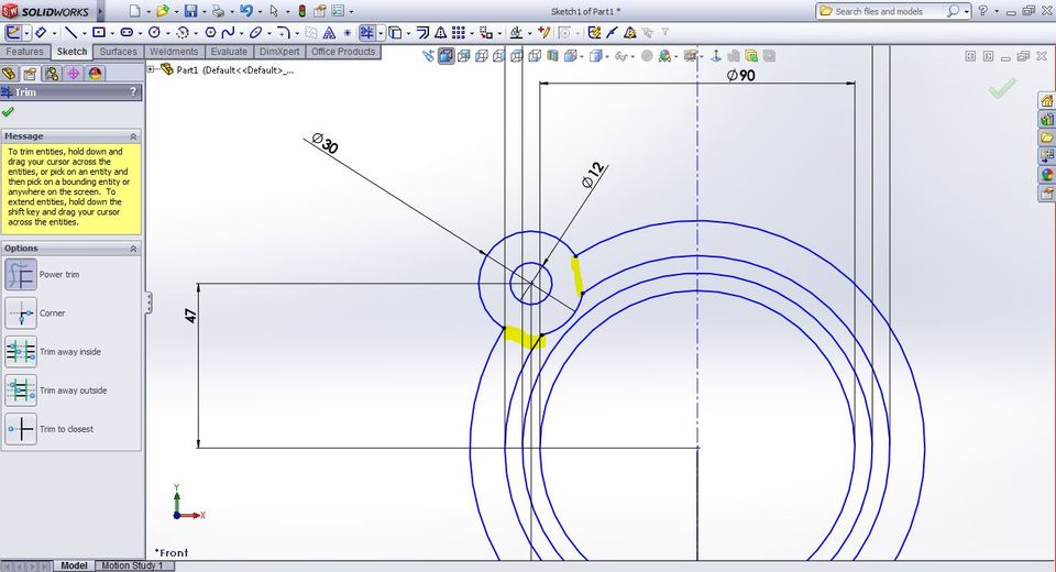

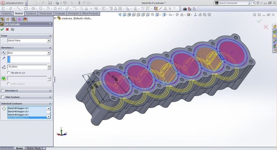

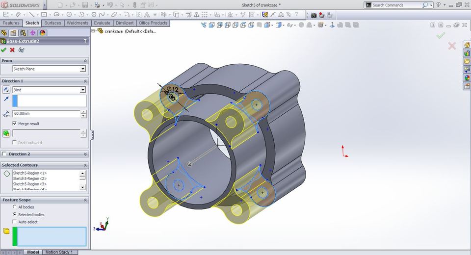

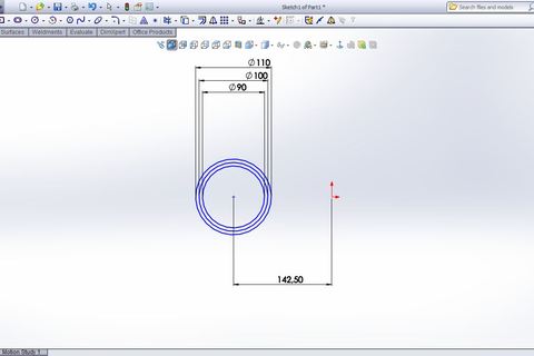

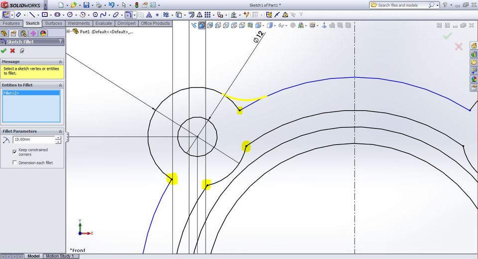

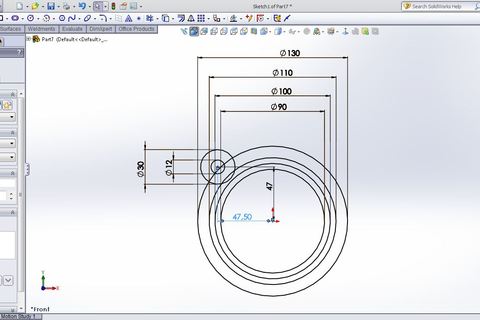

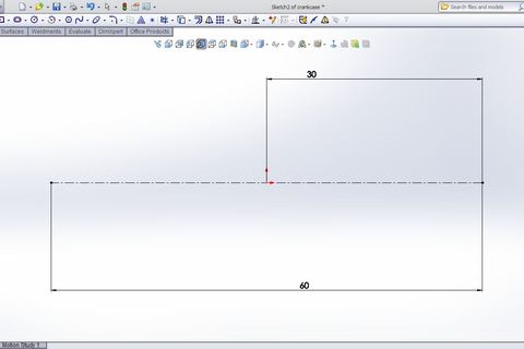

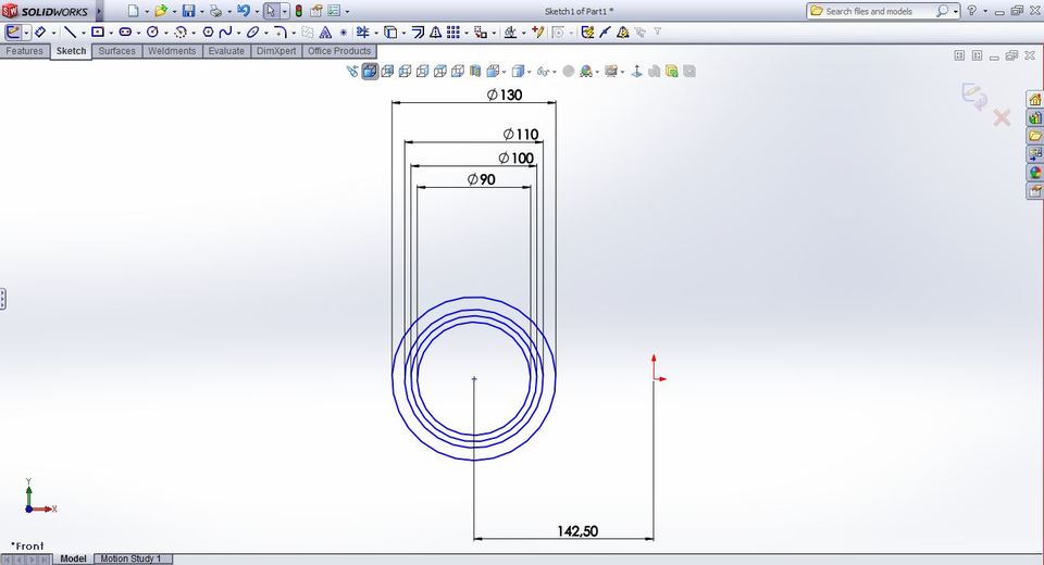

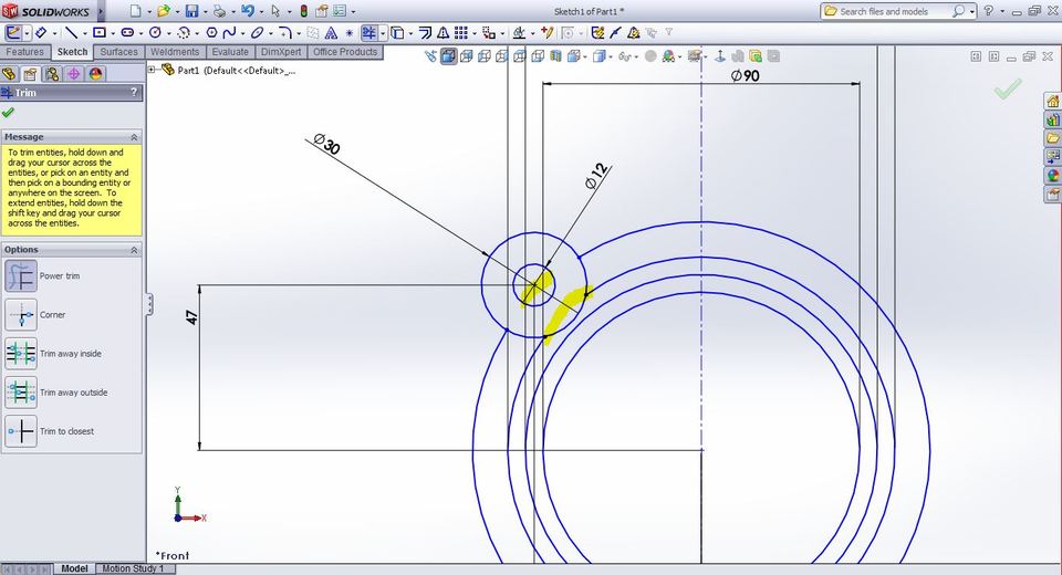

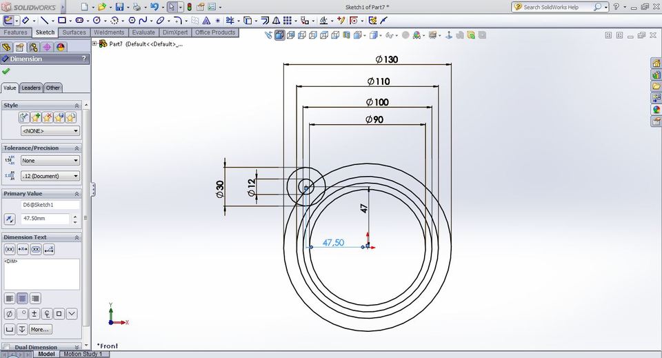

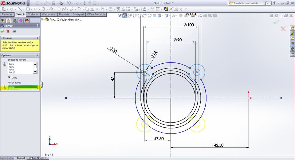

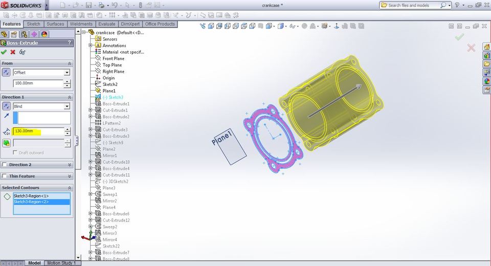

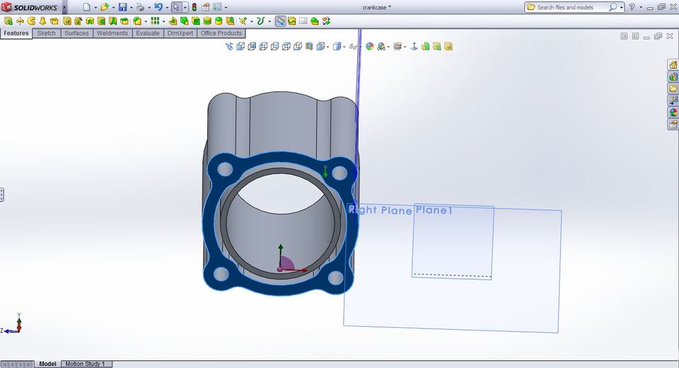

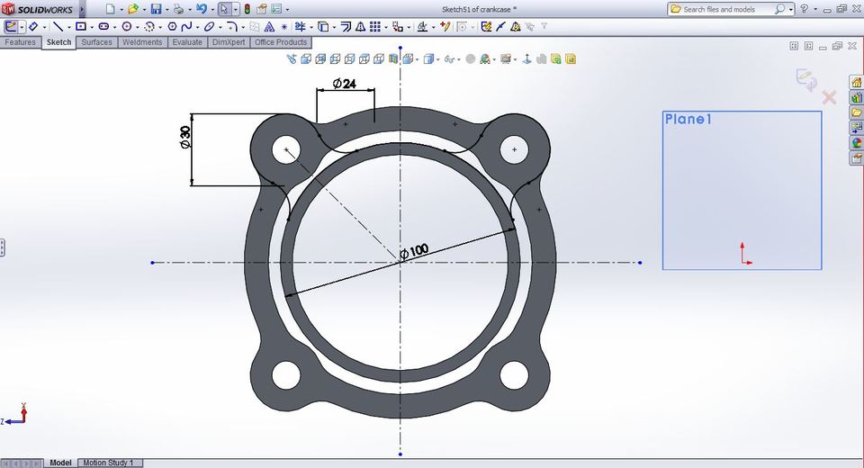

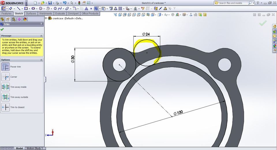

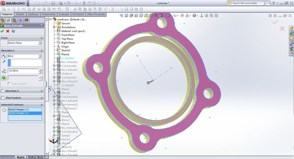

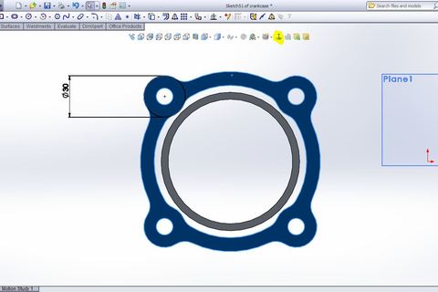

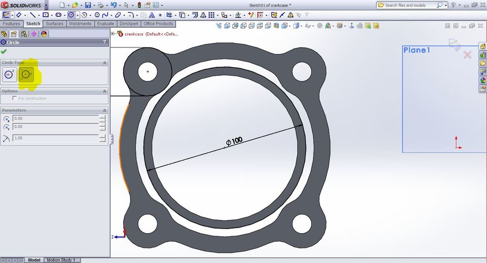

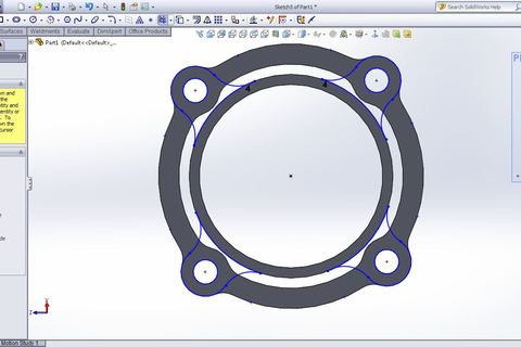

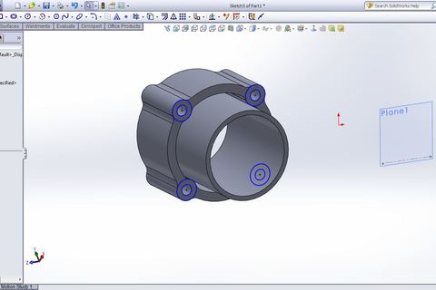

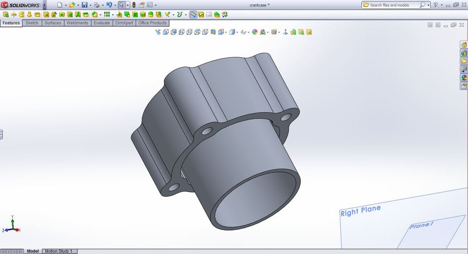

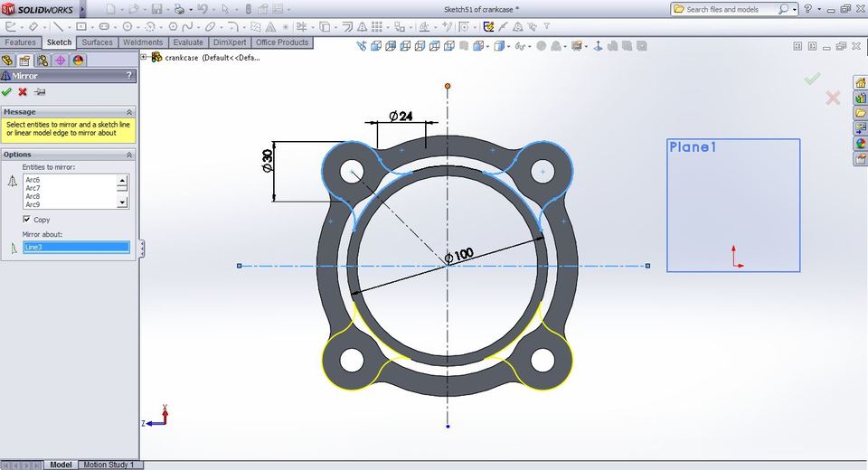

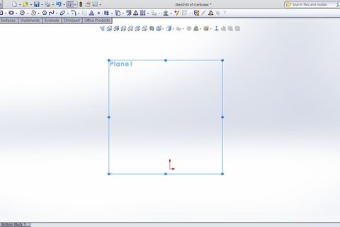

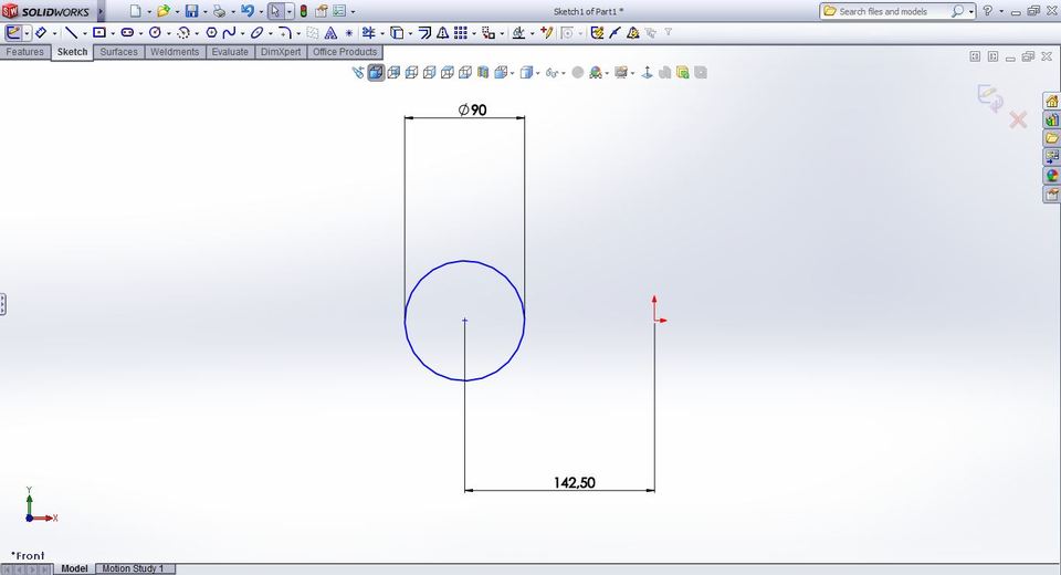

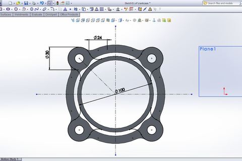

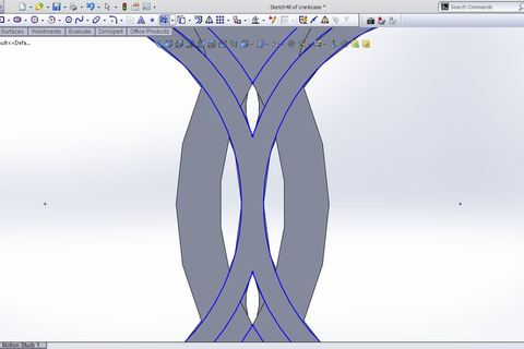

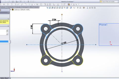

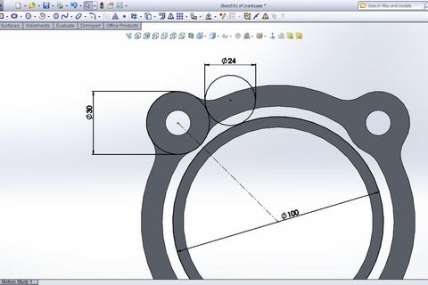

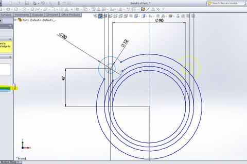

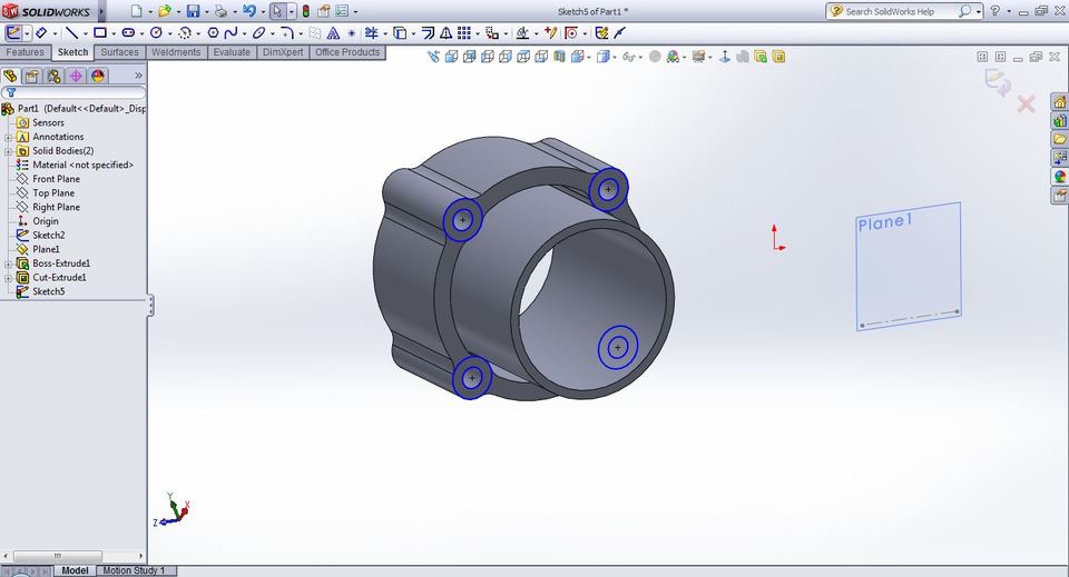

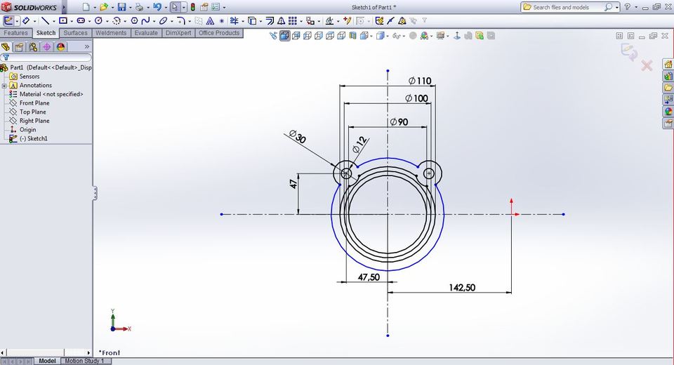

You can approach this part with three simple steps just like layering a cake lol , I will provide pictures for better understanding . And based on those sketches you can extrude and achieve the same effect . If you find that useful , don't forget press It Worked
