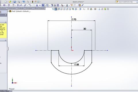

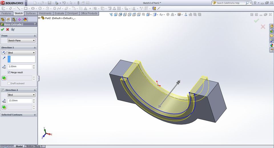

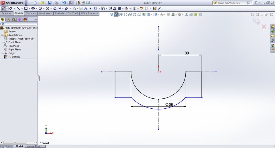

Hello, why we haw different between extrude values part1 step9 (15mm total) and part2 step 6 (11mm total) is this correct?

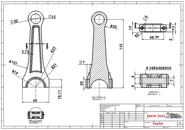

I made drawing of this part of connection rod. The dims are like ones on connection rod part 1 drawing on the end of the tutorial. Hope it helps. :)
Drawings and models of whole connection rod attached. Made in SW 2012!

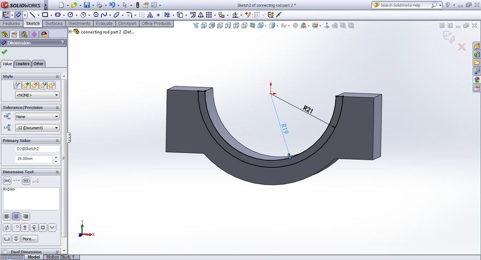

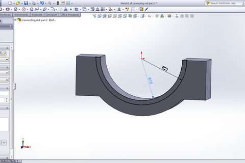

For step 7 I converted the edge of the connecting rod #2 and applied a 2mm offset to get the radius 21mm sketch, if anyone was struggling.
Cheers

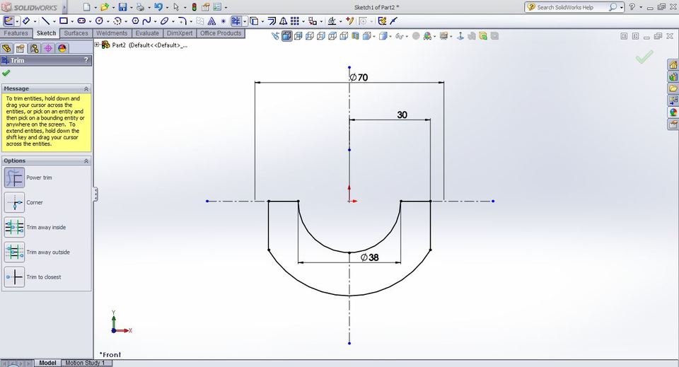

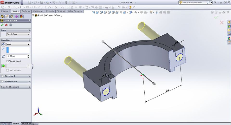

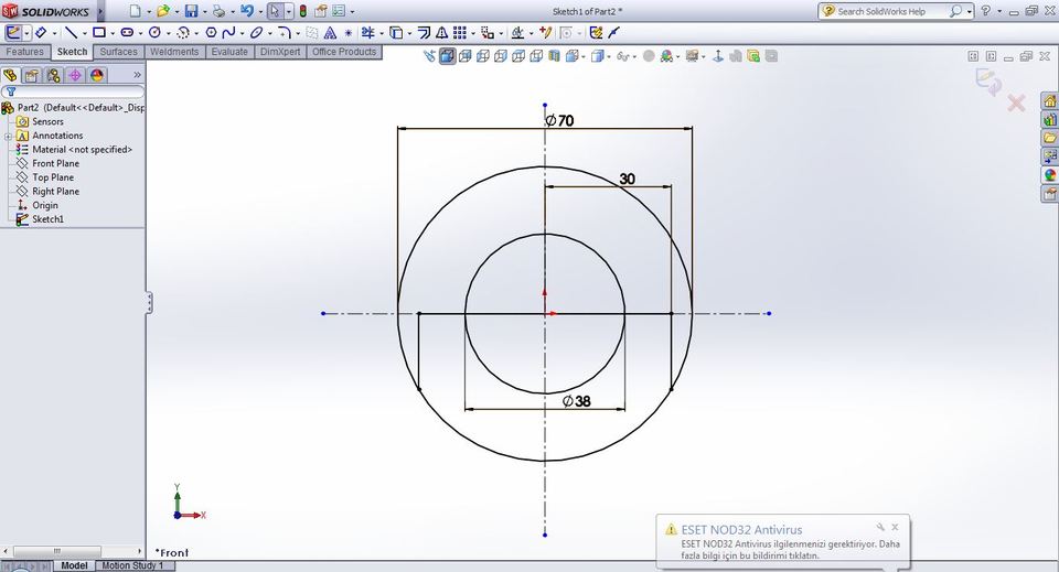

I'm doing this in Inventor and it should be easy,the problems are lack of dimensions,if you look at part 5 in this tutorial,you basically have two rectangles and two circles that have been trimmed but I can't find a dimension for the outside vertical lines in that sketch anybody know,lack of dims is the biggest flaw to any drawing,for modeling and animation purposes,is it 20 mm or 30 mm?

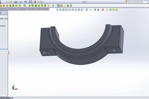

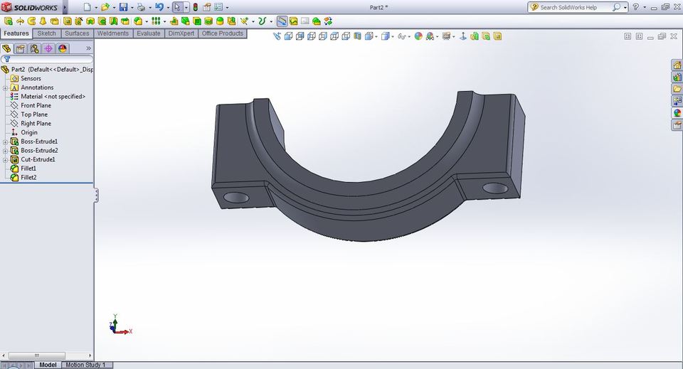

hi. uptil step 10 there is only one fillet. but in step 11 there is another fillet but dimensions are not mentioned. can any one help plz and mention the dimensions...
