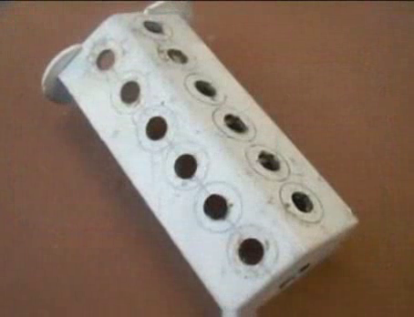

isn't u think as u joint your connecting road as per it cylinderhead is also pettern 45 degree + 17 mm increment in crankshaft axies direction.....
u can see this photograph & clear about it....

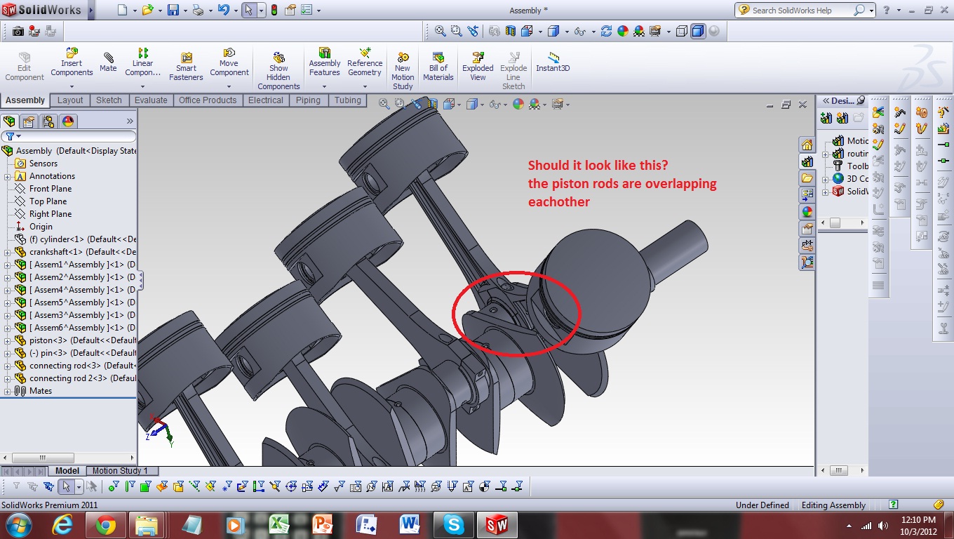

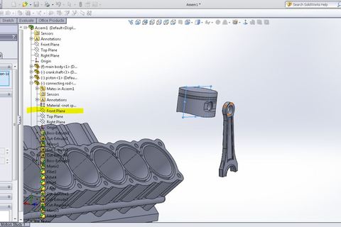

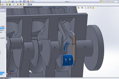

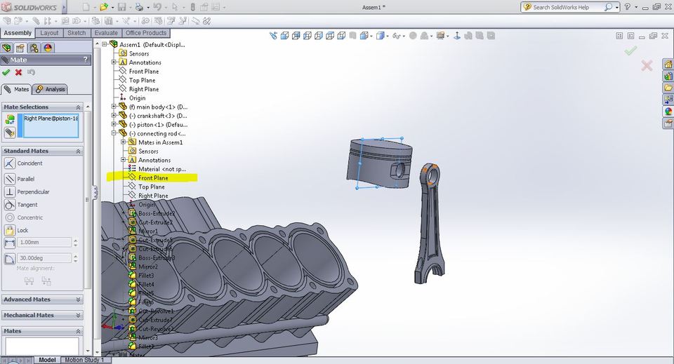

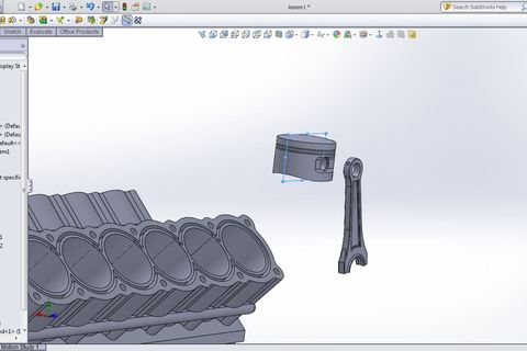

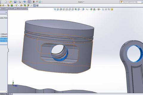

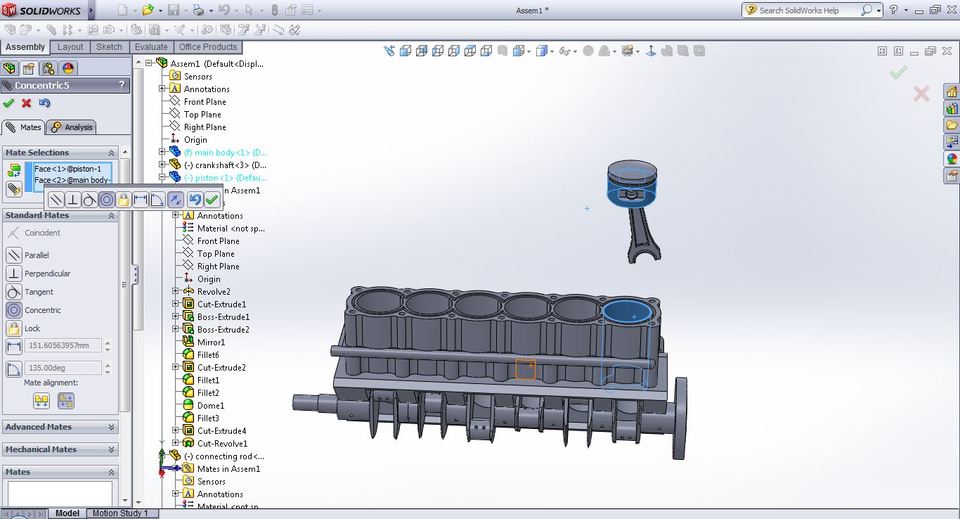

I'm doing the assembly of piston rods. In this image I hid the cylinder so I can illustrate the piston rods' position. Am I doing it right? I'm just confused because the piston rods overlap eachother

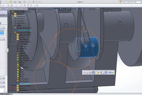

Can you check if there is something wrong with the crankcase? thanks
Brylle,
Check to make sure your piston holes dont line up exactly to each other, there should be difference between the two, then your connecting rods will align correctly. Hope this helps..
Brylle I believe that you missed one action in tutorial number twelve that is step 5.

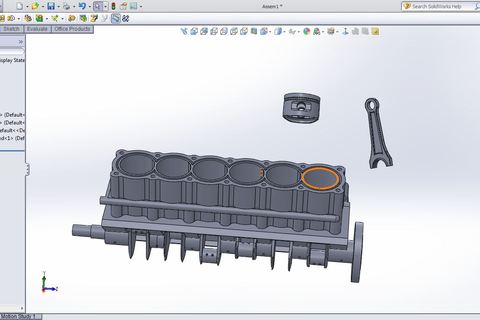

An alternative to inserting and mating 12 separate pistons and connectors would be to make a piston assembly and then insert the piston assembly into the main assembly. That way there is less mating to do in the main assembly. Be sure to make the piston assembly flexible upon insertion.

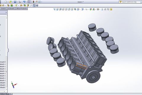

here is the assembly
