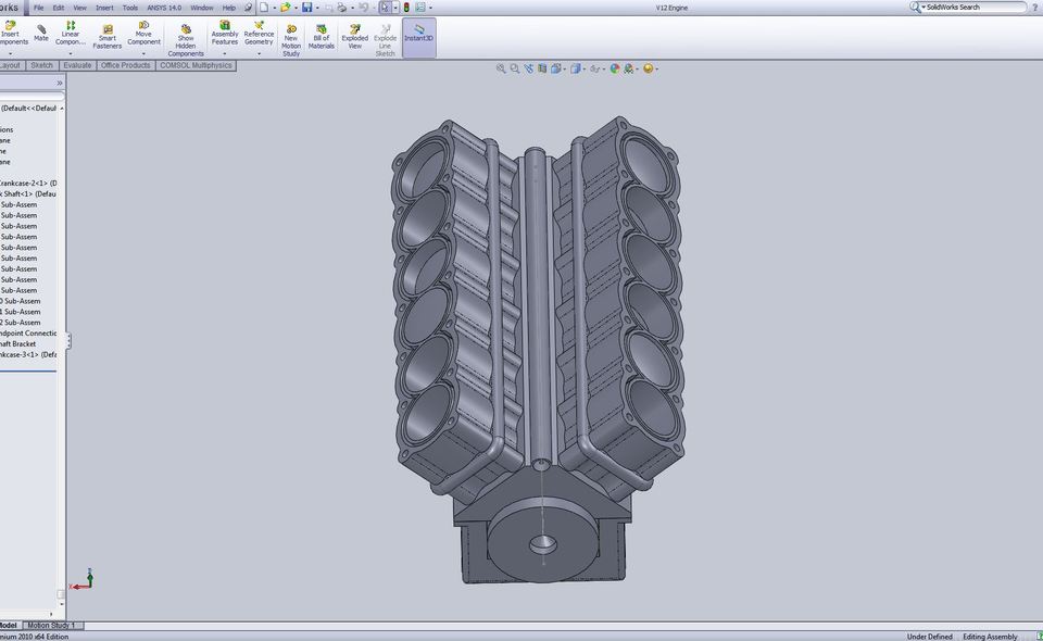

    These tutorials can help you to do your own V12 engine.
    1. Step 1
      Please dont forget to click on 'it worked' button:)
      Medium
    2. Step 2
      I will generate new tutorials. Coming soon :))

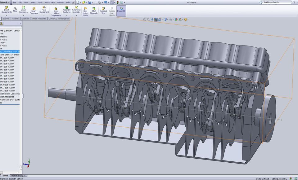

    3. Step 3
      thanks for kindly comments
      Medium

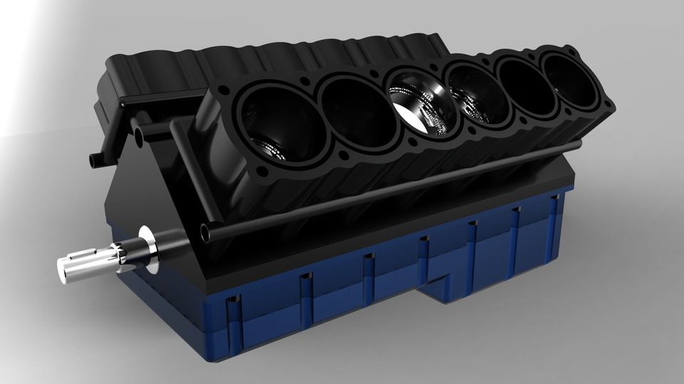

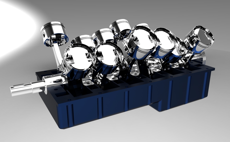

    Thanks I had a lot of fun with the model. The dimensions of my model slightly different then that of the originals dimensions, but it looks and behaves just the same, and in some areas I improved on the original. I'll be working on some rendering for my model in the coming days, but here are a few screen shots of my complete assembly. Thanks Up loader.
    Added images
    Square Square Square
