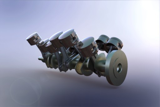

Tutorial how to make engine part 1
I will generate tutorials that explains how to make car engine step by step
I used random dimensions. I want to explain the commands and the way to make an engine. You can use your dimensions
In this part we will start with connecting rod

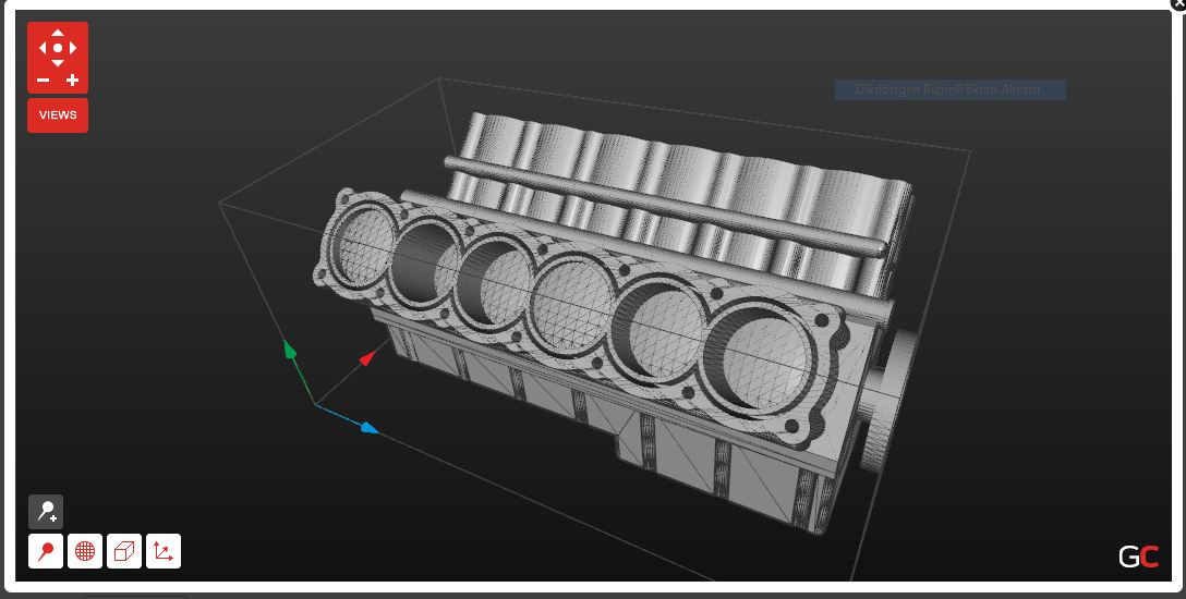

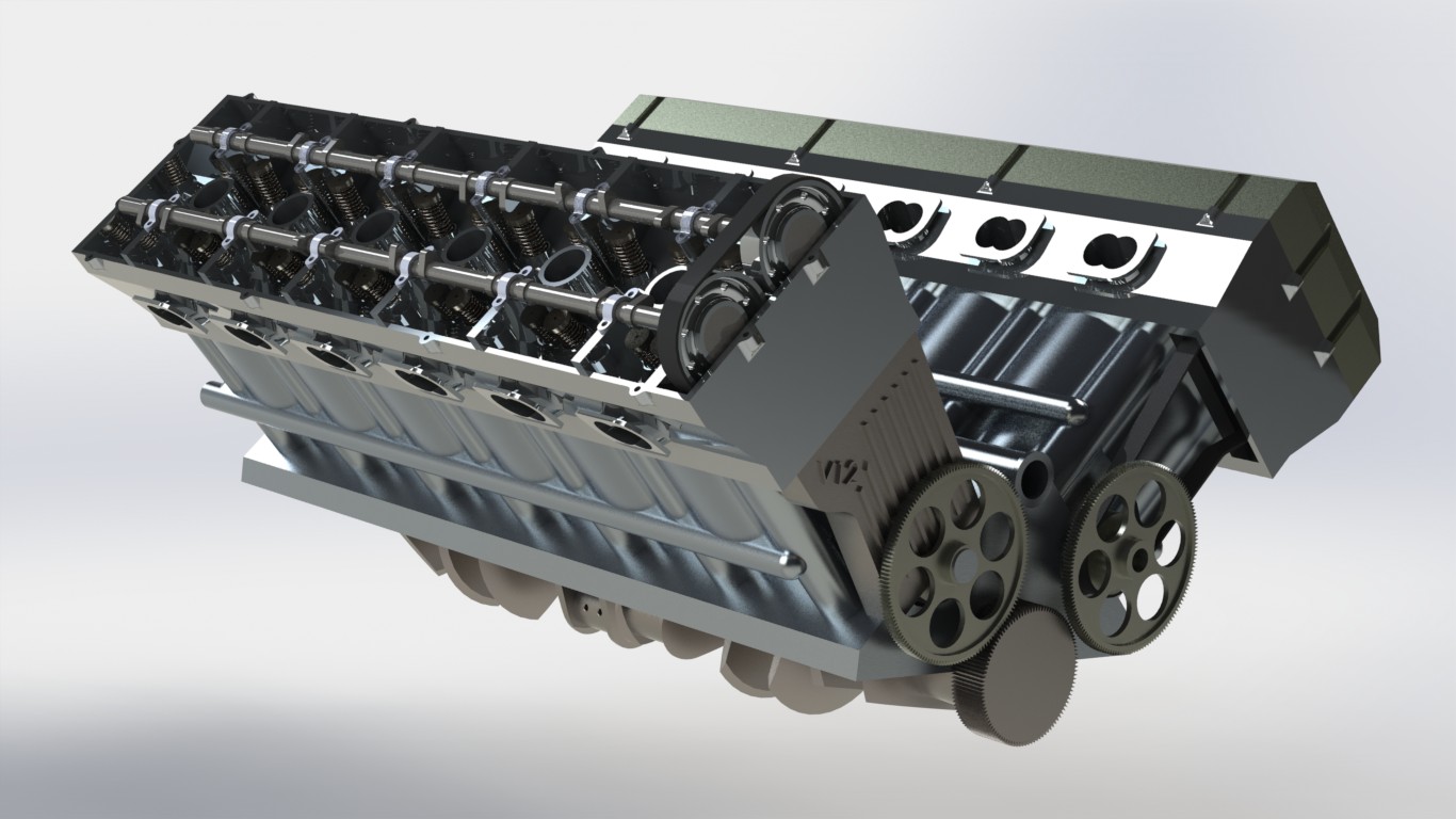

FILE: V12 engine
